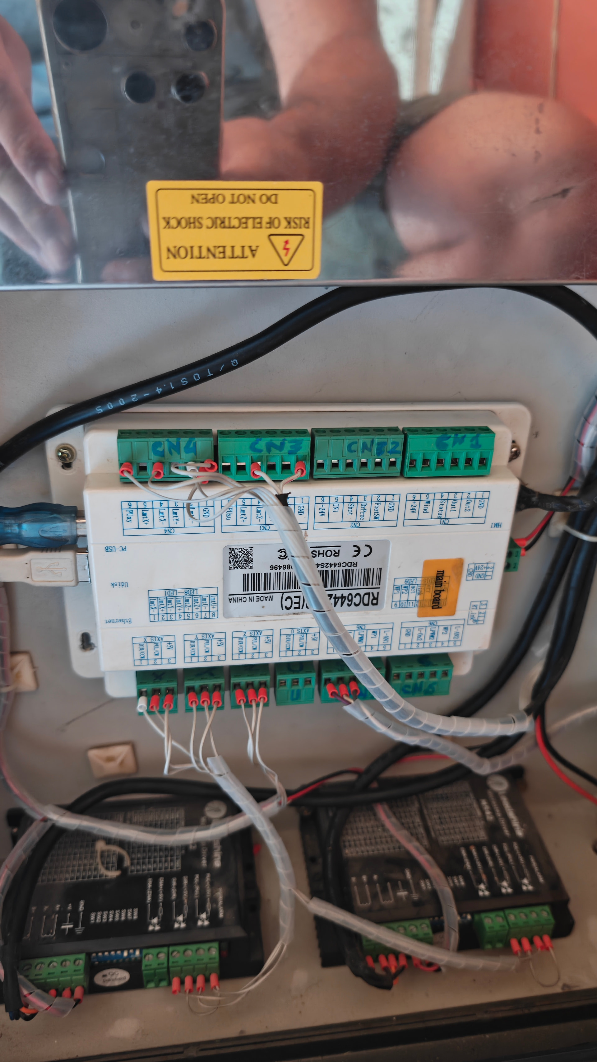

Je vous transmets une photo de mon contrôleur, je crois que le pointeur est actuellement branché sur la borne CN3 à moins que je dise une bétise…

If the red dot is connected to CN3, disconnect it. CN3 is part of the Ruida’s input/signal wiring and is not intended to power accessories, which is likely why the pointer is behaving strangely.
The Ruida does not provide a dedicated 5 V red-dot supply. These pointers normally have their own small DC supply, or can sometimes use a suitable output from the machine’s low-voltage AC/DC power supply — probably the silver box at the top of your photo (but lets see a photo first)!!
Please post clear photos of that power supply’s terminal labels, the red-dot wiring, and any label on the red-dot module. Don’t connect it to the main laser power supply or laser-control wiring.

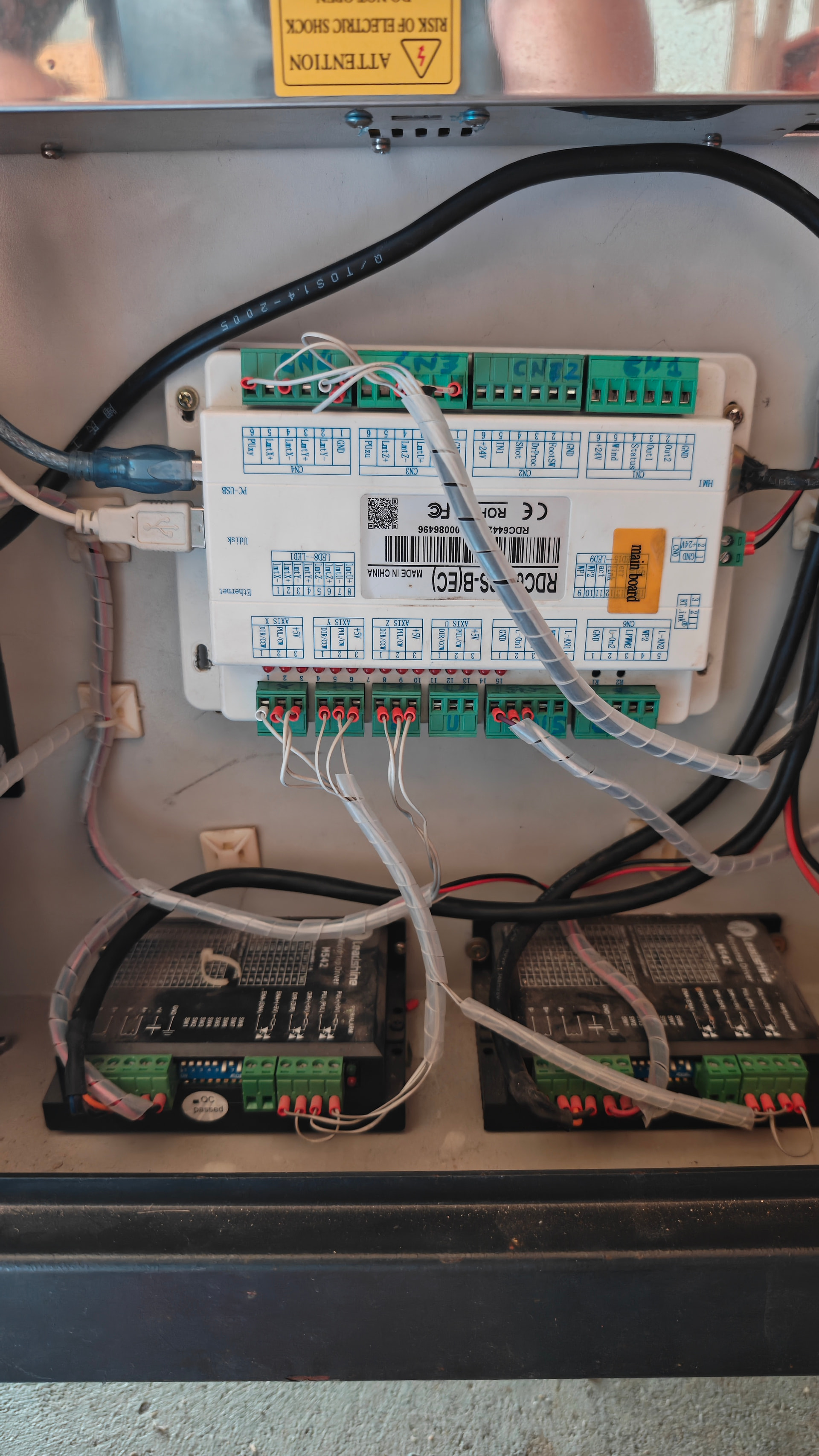

Ah, but it has 5 V outputs for other devices!
The red dot pointer draws only 20 mA, so you can connect it between the (unused) +5V terminal in the Axis U block and the (unused) GND terminal in the CN6 block.
Which eliminated the need for a dual-ouput power supply in my machine:
Works great … :grin:

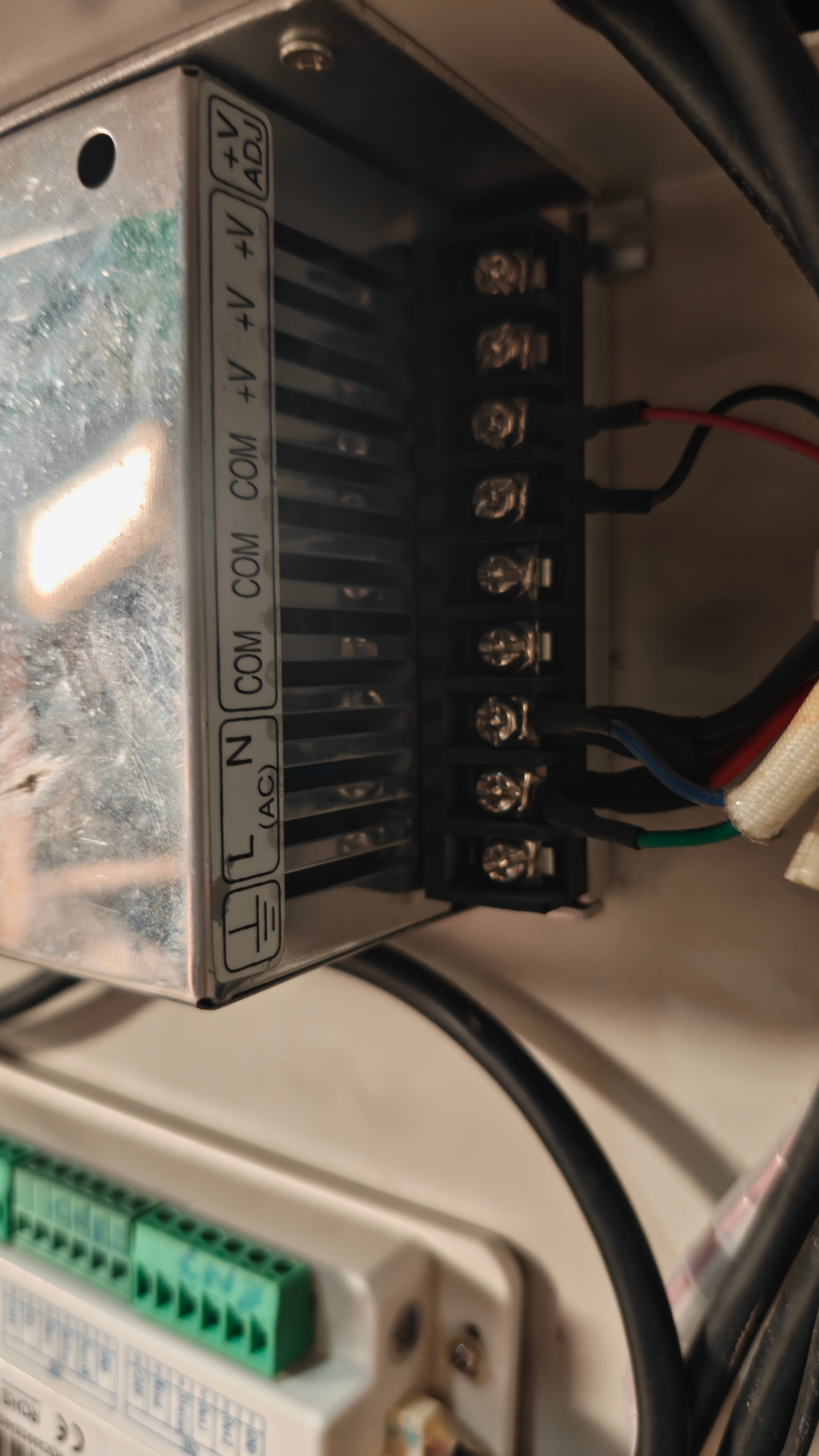

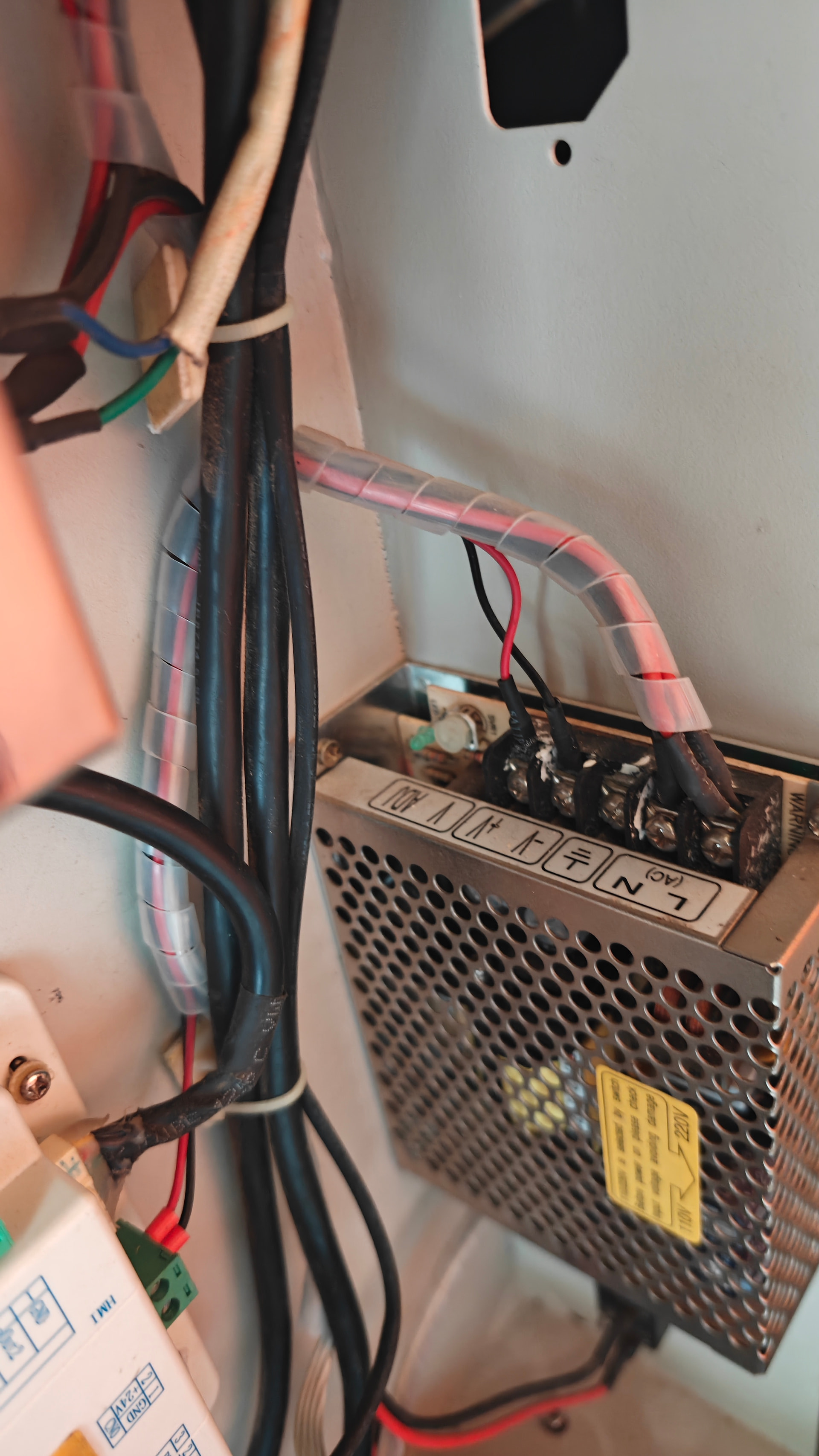

Bonjour merci pour les informations,je vous mets une photo des branchements de l’alimentation qui se trouve au dessus du contrôleur. Pouvez vous m’indiquer le bon branchement à réaliser s’il vous plaît ?

there should also be a label showing the voltage output.

Bonsoir j’ai essayé ce branchement, mais rien pas de lumière rouge quand j’allume la machine, que faire ?
J’ai aussi cette alimentation, je peux peut-être m’y brancher, mais comment ?
The red-dot laser cable on my machine has two wires:
  • Brown = +5V
  • Blue = GND
However, the color code is not standardized and your cable may have different colors.
The red-dot laser will not work if the wires are interchanged: reversing them may solve the problem.
A photograph of the wire connections will let us look over your shoulder. :grin:

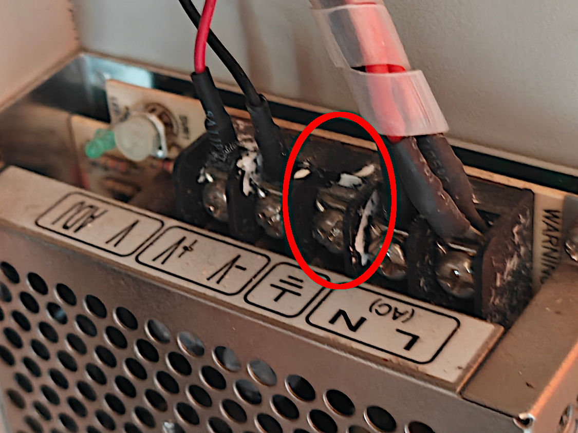

The power supply does not have a wire on its Earth Ground = ⏚ terminal:
That terminal must be connected to the power cord’s Earth Ground conductor, which is typically done at a barrier strip near the power entry point. The machine frame must be connected to that same Earth Ground conductor.
The screws mounting the metal case of the power supply to the metal machine frame are not a good substitute for a solid wired connection.
While the machine will work without the ground connection, you are betting your life nothing will go wrong.
