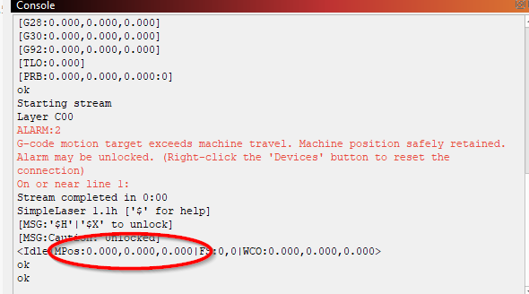

HI, I’m trying to use “pointer offset” and i get a error message; G-code motion target exceeds machine travel. Machine position safely retained. Alarm may be unlocked. (Right-click the ‘Devices’ button to reset the connection)
On or near line 1:
it was working before and now just the error message I’ve reset Lightburn, updated the firmware from Longer still no dice. i I have the Pointer offset off everything works fine. Any ideas?

the area I’m using is center of laser bed and travel of about 3" max, nowhere close to machine travel limits. I have it set to user origin and start position lower left. I get the same error code if I use current position or user origin. this was working when I first set up the pointer it started glitching about a month after I first set it up. Don’t know if it was a light burn update or something else that started it to not work. If I disable pointer offset the laser works fine. and with the minimal off set I need Y -13.mm and X 15mm it’s a short jog. I have the pointer on the side of the laser head, (see Steve makes everything) video on YouTube. I do a lot of 4x4 ceramic tile and when the pointer offset was working it made the alignment much easier (the enclosure I use makes it hard to accurately position the job) I just don’t know what made it stop working.

@NicholasL and @misken are right, your project is going out of bounds. When asked if it was an image, you did not reply.
If it is an image, check the Overscanning setting in the Cuts window. Please answer all questions to help reach a diagnosis.
Better do not use user origin. It’s very special and you need to know exactly what you are doing. Better use absolute coordinates or current position.
The reason you are getting the error is that the machine thinks it’s standing at 0,0:
At current position this can’t work, because your x offset is negative and you can’t go beyond zero. There are two (three) ways to cure this:
  1. (let’s say the “correct way”) is to home the machine first, then the 0,0 position is correct. Afterward, move the laser into the workspace by using the arrow buttons (not touching the laser head) so that it gets a true positive position. Sending it to 20,20 is enough. Then you can move the laser head manually anywhere, since the laser now thinks it has enough space to travel -13.68 on the y axis.
  2. Disable soft limits: send $20=0 in console window. This will disable the boundary check. As long as you always make sure to stay within the laser boundaries, it doesn’t harm. It’s the fast and easy solution, but technically speaking not the “correct” way, because you just disable the check and don’t use the coordinate system in the intended way :slight_smile:
  3. maybe to add another option: use absolute coordinates, then LB will already take care of the changed workspace size and do the calculation. But then you may never touch the laser head after homing, which is inconvenient in most cases.
