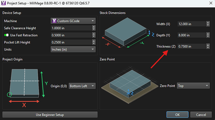

  1. set up

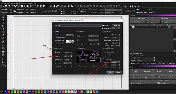

  2. Created a dual star with tabs. Set final depth to .75
    Tabs are set to partial retract.

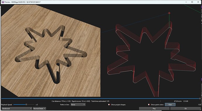

  3. Preview looks as expected.

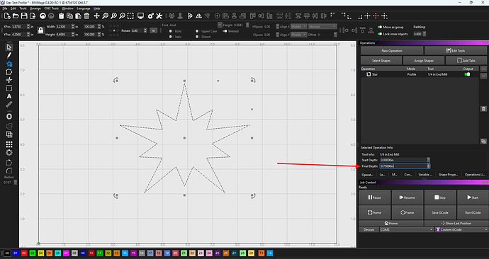

  4. Highlight final depth in operations window. Causes the depth to change.

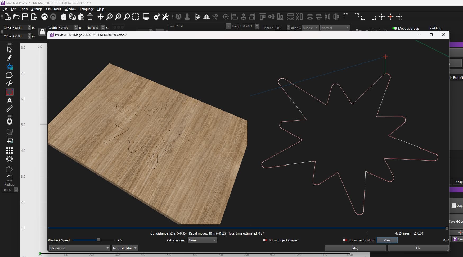

  5. Changes in depth ( shallower) and tabs change to full retract.
  6. The preview shows the changes.
