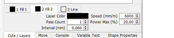

Not related to latest beta, it is in previous version also but maybe it could be easy fix to include in this release.
I noticed some issue with Interval editor of layers in **Cuts / Layers** window when using sublayers.
e.g. **Interval (mm)** is editable if sublayer is set to **Fill** and it is not first sublayer. If it is second, third, etc, then interval is editable but not working and also when using sublayers Interval is showing wrong value (editable or not editable - value is wrong and if editable it is not working ok).
Screenshots:

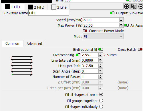

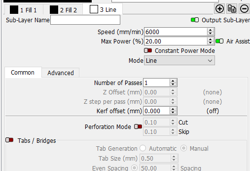

**Cut Settings Editor**
 ![image](https://forum.lightburnsoftware.com/uploads/default/original/3X/b/5/b5d3cb96ac0799bac66514779d23f42b5f85bb39.png)
 ![image](https://forum.lightburnsoftware.com/uploads/default/original/3X/7/4/747312e131270b20336f0b069b696e362b7bdc62.png)
 ![image](https://forum.lightburnsoftware.com/uploads/default/original/3X/4/3/431f6ac968bb90df93269c2b6eb965597c249e45.png)

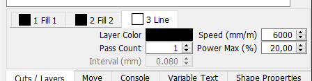

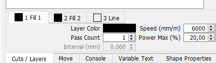

**Cuts / Layers window**
 ![image](https://forum.lightburnsoftware.com/uploads/default/original/3X/e/4/e4ca4d1084744d4fefd8126032017932292a7bc0.png)
 ![image](https://forum.lightburnsoftware.com/uploads/default/original/3X/a/8/a849a1806298f45d8a05f96bf9153dbcf4ed76ce.png)
 ![image](https://forum.lightburnsoftware.com/uploads/default/original/3X/d/b/db337315d6f425cf0d754744af8d05e56263164f.png)

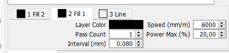

if I move **Fill 1** after **Fill 2** (without changing any settings) then Fill 1 is editable and Fill 2 is not (but again both displaying wrong value):
 ![image](https://forum.lightburnsoftware.com/uploads/default/original/3X/9/e/9eae300ff3f33caa5dfa5d2b6769b72277ad0ef8.png)
 ![image](https://forum.lightburnsoftware.com/uploads/default/original/3X/7/7/7744d8d3007718bc3fc69848ea91ea262ad216fe.png)
and finally, if I move ‘Line’ to first place, ‘Fill 1’ and ‘Fill 2’ intervals are editable and showing correct value.
