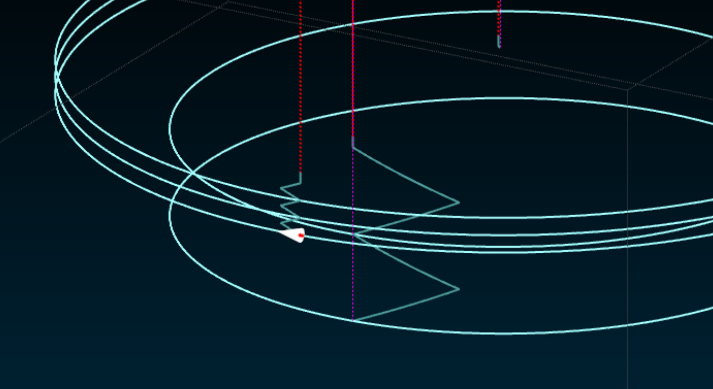

To test, I made a 100mm circle, set a profile to run along the line, and gave it an 8mm ramp. The small red dot on the right is just me marking the start point:
This is the gcode it generates:

G1 X150Y100Z-8                  ; Finished the ramp - Z = 8mm
Notice the coordinate for the end of the ramp is exactly the coordinate for the start of the shape, and the Z is the full 8mm depth I requested.
Have you checked the generated gcode on your end? It should be a simple thing to verify this.
I see no indication in the preview either - It would be easily visible from the side in the wireframe if the last part of the zigzag was at a different height than the actual path:
