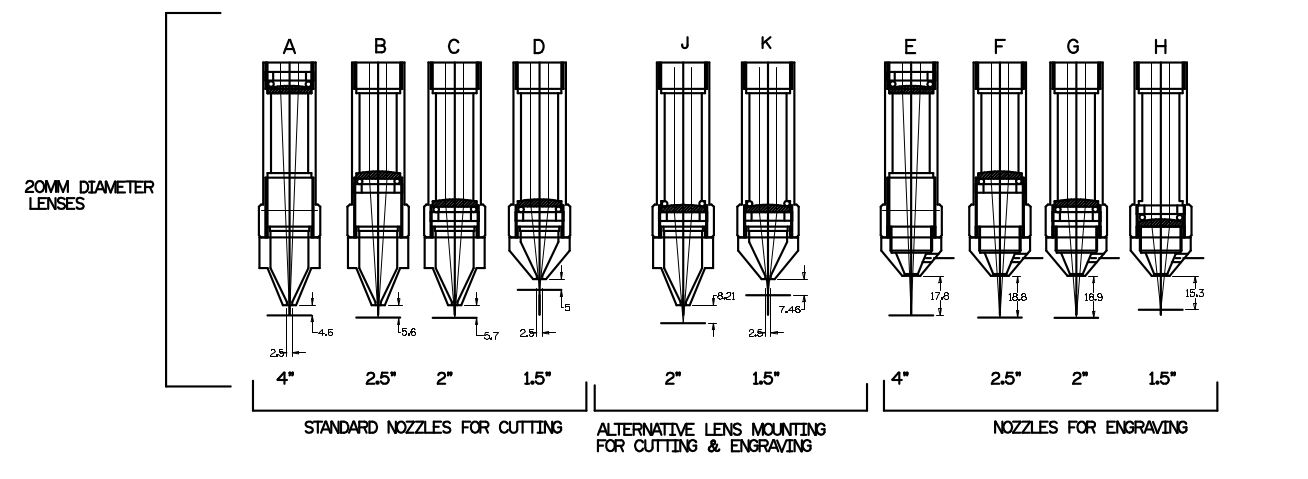

Jack, you said something about your distance from nozzle with a 2.5" lens on the Omtech. What did you finally set yours. I have my new lens and lens tube installed. I set it at 10.5mm, speed 25mm/sec, 35Max and 35Min. Still burning the edges more than I want.Ideas?
As much as I try to get a better focus, I can’t do any better than this chart… Not sure what lens combo you are using. I do ramp tests on all of them to ensure they are the best I can do. I leave them tube/nozzle so I can just put them in. I find little variance, usually from a ‘knot head installation’ somewhere with the lens…

The 10.5mm was what I got with the ramp test. Your chart shows 5.6mm. That would cut with one pass. Do you do more than one pass?
I pretty much don’t do material that I have to make multiple passes. Always seem to be a very rough edge or at least burn like…
I’ve been meaning to use the 4" on my kerf testing template to see how close it is to what’s in the diagram.
Take a good look and make sure the diagram has the lens mounted in the correct position and you have the right nozzle.
Can’t tell you how many times I’ve confused this… That’s why they stay ‘pre configured’ to just put in and attach the air…
My new nozzle has the lens glued in???
Bummer… Never seen that ‘tact’ before…
I guess you’re going to have to go with whatever the ramp test gives you.

Yeah, many of the manufacturers want you married to their lens tubes so they glue them in. Measure the OD of your lower tube, there’s a good chance there is a generic replacement that will let you swap / move lens’ easily. I use the Cloudray C series ( the E series is the same but a different OD ) that lets me put anything from a 1.5" to a 4" in the same tube just by changing the mounting positions.
