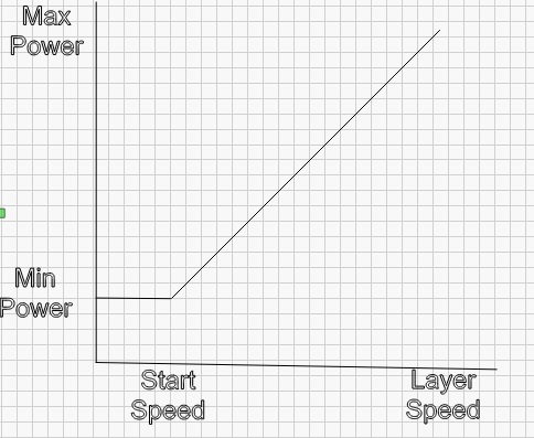

If you are drawing a vector where the head speed changes, the controller uses the Min/Max power on the layer in association with the ā€˜Jump-off speed’ of the controller.
Anything at or below the ā€˜Jump-off speed’ will get low power, it will be ramped up to max power at the set speed.
I originally had ā€˜start speed’ which is incorrect.
I made a graph from my experience with the Ruida, have no clue how correct it is, but it appears useful.
min-max-power-graph
My tube doesn’t like to fire much below about 9.5%, depending on temperature.
At 10% it will generate a 10% duty cycle of the pwm. I don’t think manual pulse has any relation to the min power.

I gave you the wrong item to change, please check out the correction.
The Jump-off speed is what I should have stated.
