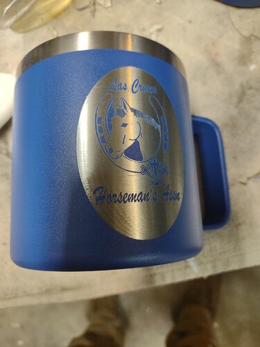

Diode lasers are pretty effective on organic material. Wood, leather, etc.
This was done with a 5w laser and Ortur Afuero machine :slight_smile:
