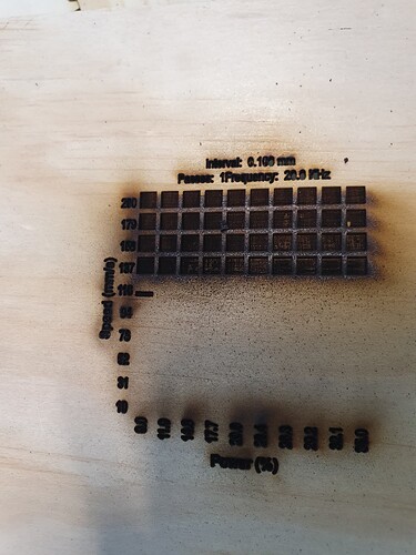

Sorry: this is going to a long one so apologies in advance. I blew the tube recently in my 100watt co2 laser. I replaced both tube and power supply with new ones from a company in Australia. All went well fitting it up but as soon as i tried a material settings test all hell broke loose, the first square at 9%power burnt straight through 3mm ply, and everything else was just catching fire. No matter what power setting i chose in lightburn each attempt was the same. Had no choice but to take it out and reinstall my old power supply and straight away problem solved. The tekkie who installed the power supply us adamant it is faulty: so i messaged the seller, told them of the issue and asked for a replacement. They wont do that and have said im not programming the power supply correctly. My question to you guys is… is he correct ? Can a laser power supply be configured for different wattage machines ? My tekkie doesnt think so but the seller is adamant. Any advice greatly appreciated. Ive attached

Squinting at the product description, if you have the DY13 model the maximum current should be about right for that machine. However, the supplies have an internal trimpot to set the maximum current and it’s possible to be grossly misadjusted at the factory.

  1. The pwm or analog voltage on the IN terminal controls the current limit
  2. L goes low when active to allow the lps to excite the tube or lase
  3. P (active low) is a water protection input to prevent lasing if there is no coolant flow.
Measure the IN voltage at 50% power setting and see if it’s 2.5V or thereabouts. There is no need to power up the lps, you can measure it at the controller.

Good news. The company that supplied the power supply sent a new one, worked straight away so obviously the other one was a dud.
