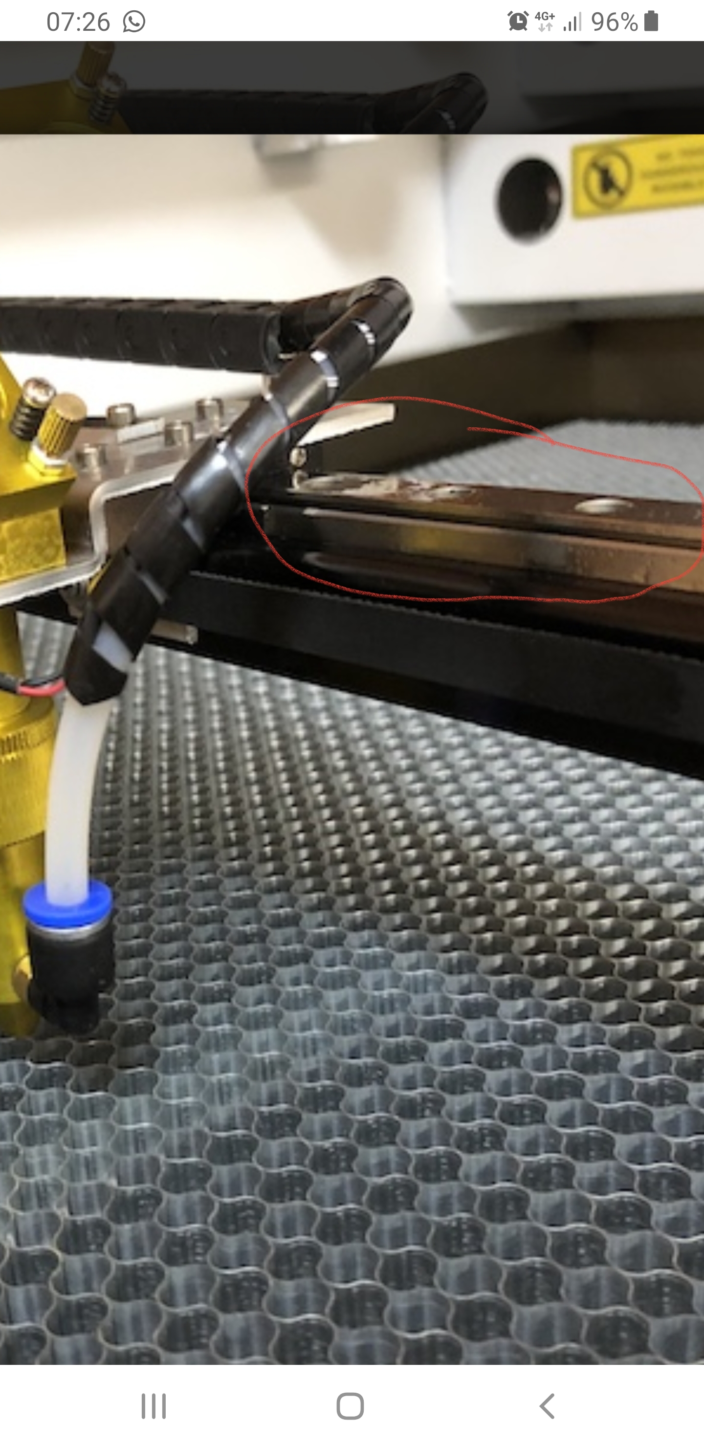

Thank you Andreas.
This is oil and reflect of light.
But I wiped it just in case now.
However bad line also.
and I tried to adjust belt tension but same quality.
