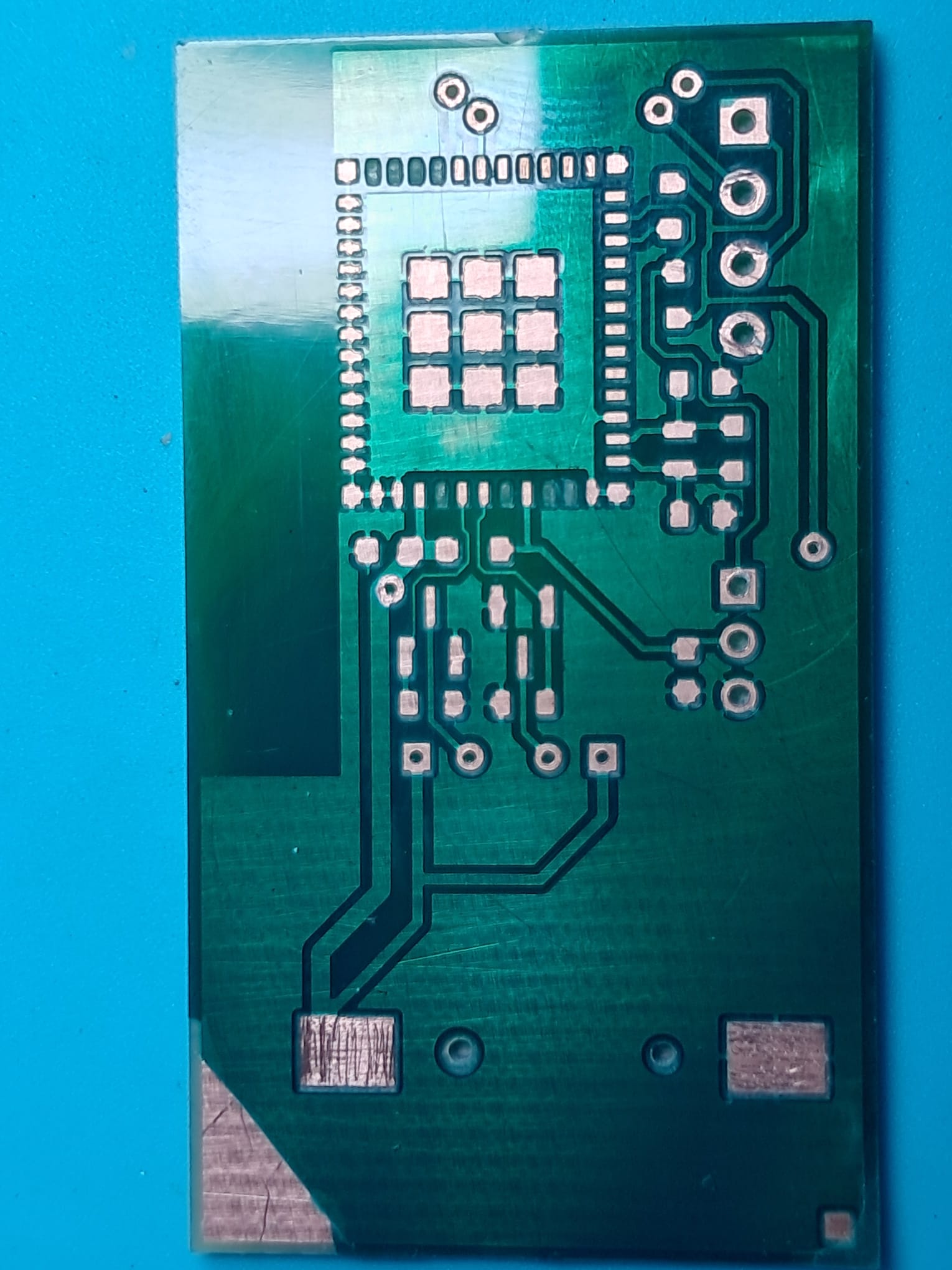

When I open or import a file (svg, dxf, gcode…), the design is placed in the center. How can I open it using original coordinates? My use case: I use a CNC for milling PCB traces (using gcode for that). The same CNC supports also a laser module, which I want to use for removing the solder mask over the pads, so I need to keep the original coordinates.

The reference is half of an issue, in my case. My project uses 0,0 as reference, but the CAD considers the origin to be in the upper left corner, so a translation is necessary. However, my CAM (CopperCAM) takes care of that and outputs gcode files having the origin in the lower left corner, but that gcode is still translated to the center of the table. Can’t use directly the gcode from CopperCAM because that one is for mill bits and there are a lot of changes to repeatedly turn the laser on and off.
My workaround is somehow similar with yours, but I don’t like it much - I open with a text editor the gcode generated by my CAM and look for the lowest values for X and Y, then open the svg for the same layer in LightBurn (should work with gcode, too, but I believe LightBurn generates better paths for laser), select the entire design, set the reference to lower left corner and change XPos and YPos to the values taken from the original gcode. The mill bit diameter is set to be the same as laser beam diameter.

I can’t see any attached file. Anyway, I am aware of G90/G91 commands in g-code and G90 is close enough to absolute coordinates for me. The problem is that LightBurn shows the image centered, even though the input file contains coordinates. And if I tell Lightburn to use (0, 0) as reference, it will draw the first element of the image starting at (0, 0), even if in the original design that element was at a different position (let’s say my file contains only a 1mm square having the lower left corner at (1, 2) - LightBurn will put the lower left corner at (0, 0)). I corrected this by finding the lowest X and lowest Y in the original design and using them as offsets in LightBurn, but it’s a supplementary step and I was hoping to avoid it. Attached is the current result - green layer was burnt with laser, the traces behind it were milled.
