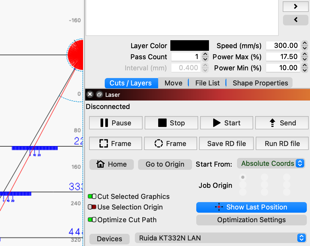

When I click preview I am getting the message "One or more shapes are crossing The edge of the machine workspace and will not be sent. New project. Any ideas or tips would be greatly appreciated.
You receive a message about the error. There is something outside your work area. It actually protects the machine from running over its limits and crashing into the frame.
Any idea what is there or how to remove it? This is a new import and there shouldn’t be any thing else there.
Absolute Coords and Cut Selected Graphics as a basic setting.
If you can’t see what outside your work area, hold the Shift key and click on the right side, on the layers you have active, it shows all that is in this layer.
Yea those are the settings I had on. Nothing else is showing up other than the new project.

Use CTRL +A when you go to delete a project. That will select everything. Sometimes things are outside your field of view and get missed.
Just tried that and still doing the same thing
Upload your file so we can take a look.
And a screenshot of Lightburn with the project loaded.
Thanks you everyone for the help. I tried all the suggestions and couldn’t figure it out. The same download wasn’t giving me issues on my other computer so I just deleted and redownloaded LightBurn again. Problem went away! Thanks again for the help!!
