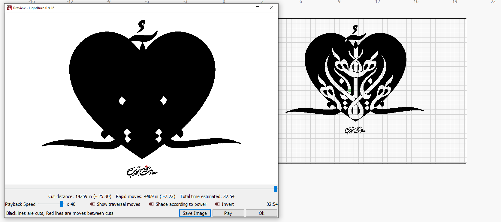

Hi,
My preview is not same as the the actual project layout screen, Is this mean my actual job also would be messed up. please see pix. Thanks!
 ![image](https://forum.lightburnsoftware.com/uploads/default/original/3X/9/5/95dad8043c5415eaea81a795859c2661b5e7d14e.png)

It is all about the fill “boundaries”. When designing, you need to understand how LightBurn uses boundaries to define what get filled and what does not. The following is a great illustration. Have a review of that, and if you are willing, post the file so we can take a look. 🙂

You might also have set “fill shapes individually” instead of “fill all shapes at once” for that layer. If the system can’t easily tell which things are inside / outside other shapes, it might fill them one at a time, which would look different.
