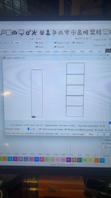

Preview screen and cut result are different than my desgned shape
So I created a rectangle with a slot, I set it to a cut layer and checked the preview. The slots are not showing up on the preview. They also don’t cut. I tried another file and the display is different than the design on the preview and cut.
Can you post the file so we can look at it?
unfortunately I deleted it by mistake, I found out the issue. My Kerf settings were too much as soon as I reentered it I can see the preview and the cut was perfect. I still have no idea how it was changed.
