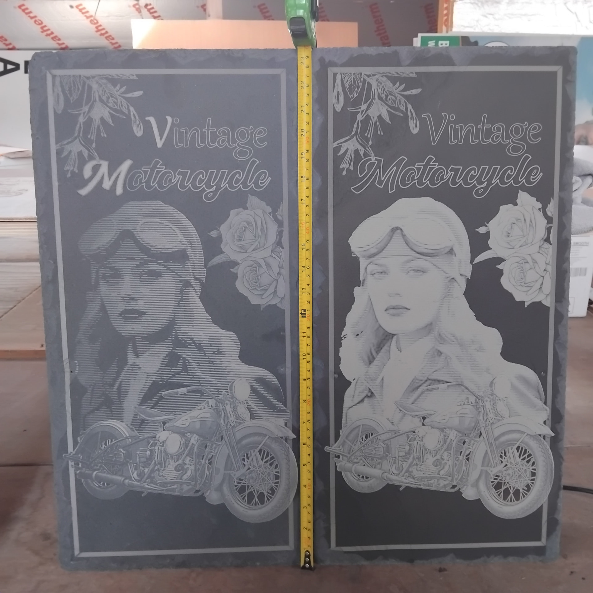

HI Oz, hope your well.
Is there any direct relationship between the tones used in the preview or the image adjustments window and the output power values at the diode module.
Sudden thought! Can the module power output values (#values) be found in the gcode.
The actual effect on the material is a separate concern at this point.
I’m trying to find a way to carry out what’s called ‘matching histograms’ in the photo image processing software ‘DarkTherapee’, before transferring the image to LB. I’m thinking that is what LB does with ‘Material library’.
The effect on the material will be captured from a LB material test and the Raw data sample will be used to calibrate the the first histogram (from the original image).

Here is an example of why I see the histogram matching as being useful.
 ![IMG_20260717_123730](https://forum.lightburnsoftware.com/uploads/default/original/3X/0/2/02705fecf0dd5c1bebfb6b0bac93eb23d20ebb49.jpeg)

> [@Pete.IRL](#):
In grayscale image mode, yes, though the numbers from the image go through a gamma correction table to linearize them, then have whatever brightness, contrast, and gamma you apply put back on them first. In any of the dither modes the only output power values are 0 and the Max Power value you specify.

Thanks Oz
I’m going to attempt a custom tone mapping curve, LUT based on a LB material test.
All I need is a big white-board and some dry-wipe pens!
