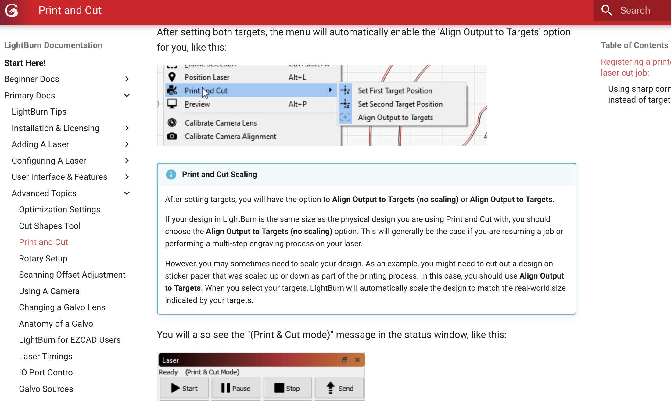

Once I’ve defined the 2 targets, I get a message asking me: “align outputs with scaling or align outputs without scaling” I don’t know what are these 2 options. Can you explain that. Thanh you
Thank you very much for these explanations
