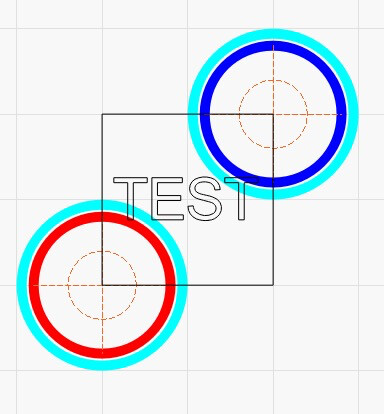

Print & Cut not recognising I've moved the 10w laser for 2nd Target
OK, I’ve watched the Lightburn and multiple (ChalkWatts, Computer Creationz, The Louisiana Hobby Guy) videos on print and cut
Design starts at 30x30
Destination start: 80x80 (bottom left mark on wood)
P&C settings
1st Target position : 80x80
2nd Target position : 100x100
Consoles shows (Get Position). All seems correct
1st: X:80.00 Y:80.00 Z:60.00 E:0.00 Count X:15840 Y:14400 Z:24000 B:0
2nd: X:100.00 Y:100.00 Z:60.00 E:0.00 Count X:19040 Y:17600 Z:24000 B:0

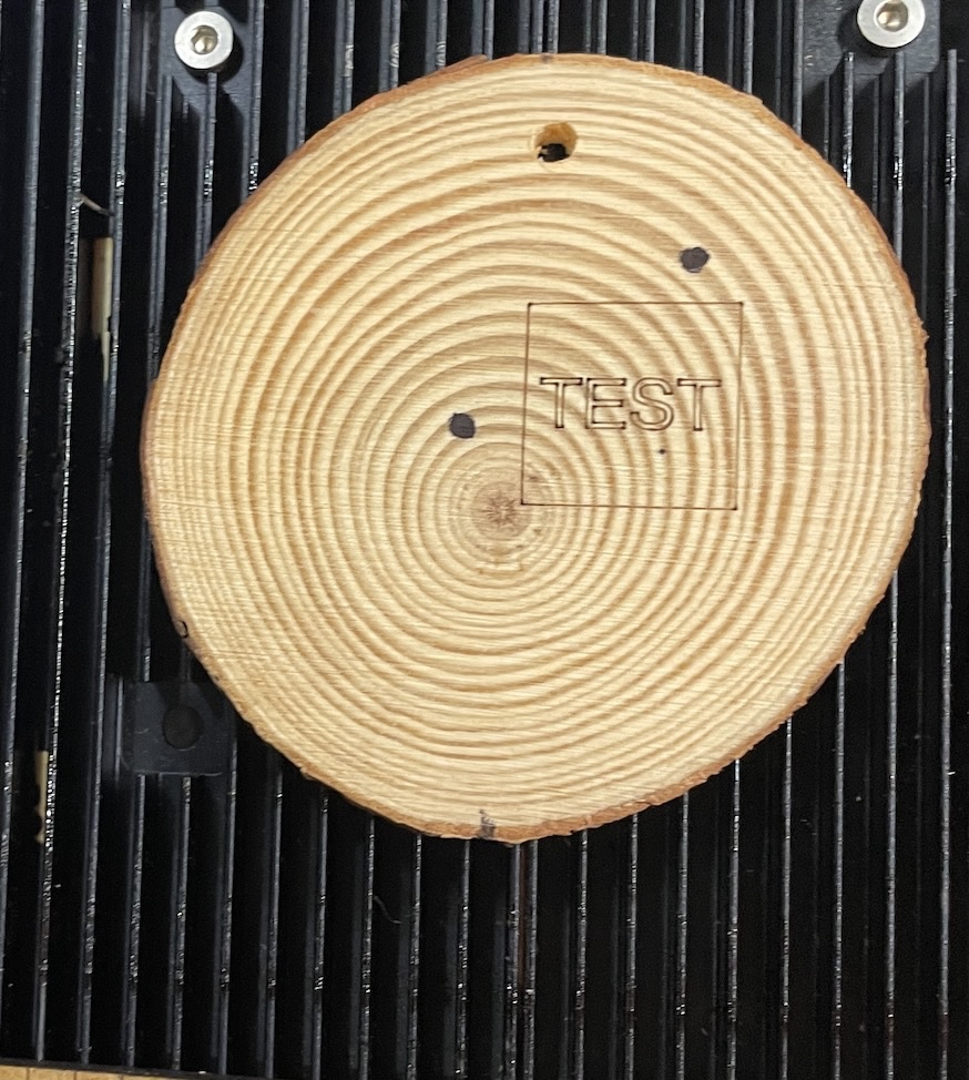

You can see my marks on the wood and the print has drifted down and across
Console output never report being shows every being near 80x80 or 100x100 when burning
Hope this is clearer, but the prints drifting for some reason
I have irregular shaped items and I want to guaranteed it prints in the spot I tell it to. I thought that Print & Cut was designed for this task (Kim and Garrett Make IT say the same thing)
Design (30x30)
The way the design is off from your targets appears like you may have a pointer offset enabled. Is that the case? Are you using the pointer to define the targets, or actually pulsing the laser at those points?
Thank you for deleting this one. I will comply with your last line.
Thanks for reply. Offset isn’e enabled. I fire laser and using the move function in LB to move to it or even the Go function.
Ok, that removes my theory then.
Thanks for trying much appreciated

Switched on the Enable Pointer Offset and set to -5 x 8.5 which is what the offset was when it tried to print and is wasnt aligned. That worked!!! Out by a mm but that might of been me lining up the laser when setting the target points.
The way I worked out the offset was I printed a square separately which would be my target, then turn off the square (output) went back to my original shape and switched on again (Output) , set 1st & 2nd targets to the orginal shape Let it print. Measured the difference and entered into Offset .
I just need to remember to do that on P&C and then switch off.
