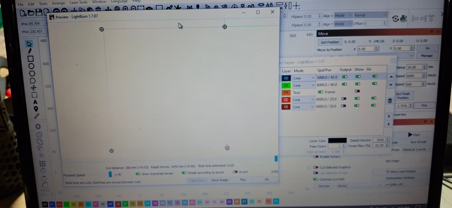

My first time trying the “Print and Cut” and I have run into a problem and I can’t work out what’s wrong.
So what’s happening is I cut the first section of a 3 part job,
then I set the marks up for second sections, I hit preview and nothing is showing to cut, The layers to be cut are turned on but its not working.
only thing its burning is the cross hair markers.
am I missing something???
Perhaps Ignore out of bound shapes if possible is turned on.
If so, then because Cut selected shapes is off, anything mapped outside the machine boundaries by Print and Cut will be ignored.
Although I see the targets, I don’t see the notification in the lower right corner saying Print and Cut is active, which requires hitting Alt-3 or Alt-4 after setting the targets. It may have vanished due to other messages, but make sure it’s enabled.
The targets seem perilously close to the machine borders. Putting targets on the corners / cusps of the shapes well inside the borders may help. Check the PnC doc for some suggestions
If those don’t move you further along, upload the *.lbrn2 file so we can look over your shoulder.
Thanks ednisley
