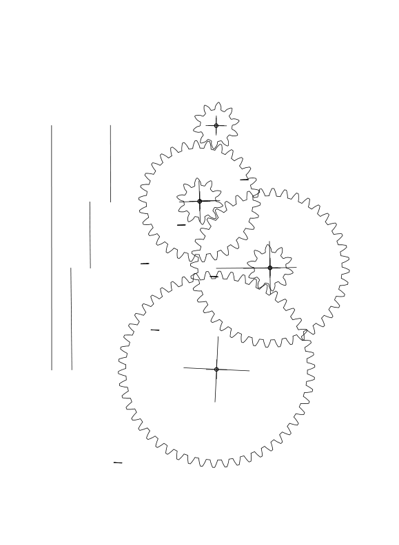

Are you selecting the Tool Layer?
With Tool Layer;
 ![image](https://forum.lightburnsoftware.com/uploads/default/original/3X/2/3/2369023f7c043619f490eedc4d59eb8d13262463.png)
Without the Tool Layer:
 ![image](https://forum.lightburnsoftware.com/uploads/default/original/3X/e/4/e4d912f30acbffb1302c9be26784edff7d8f0be0.png)

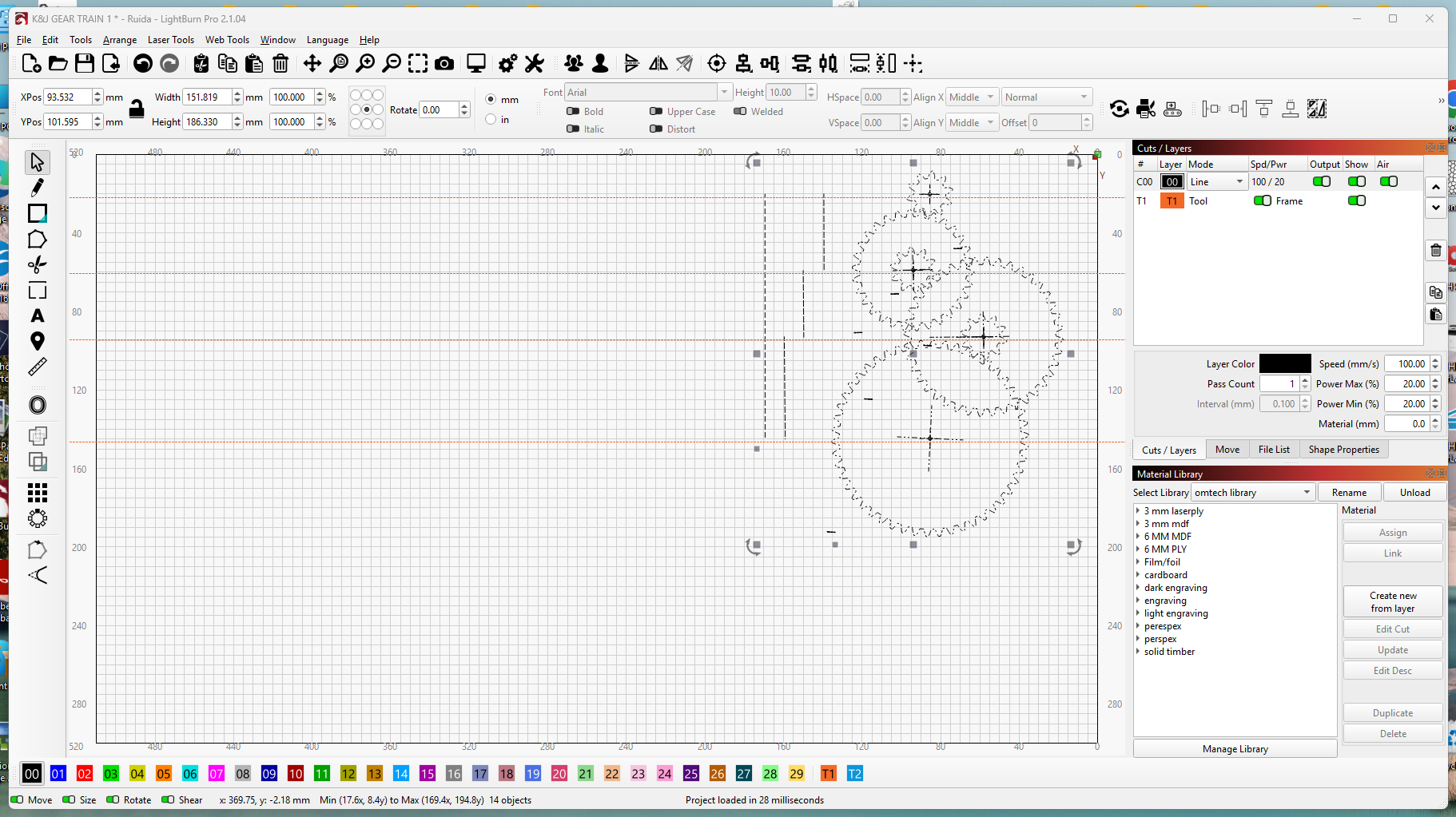

A screen shot of the lightburn file as requested
 ![gear train](https://forum.lightburnsoftware.com/uploads/default/original/3X/d/3/d3b9cc0fbe743c55a28d319b05b4665afaf9d3fc.png)

a screen shot of the lightburn file

Thanks for the reply. I am confused with what you sent about a “Tool Layer”. Irrespective of how I select the layer (Only one) it still does not print, yet if I only select 0ne gear shape it will print ok.

Problem solve3d. I had a unwanted line of a different color in the file.
Oonce emoved all went OK

The T1 Tool Layer are the red Guidelines in the project.
