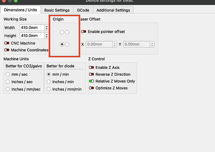

Why is my ray5 10w printing backwards

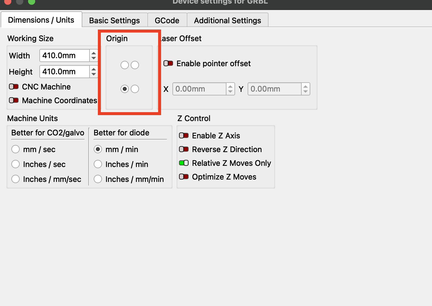

You most likely have the machine origin set incorrectly. Very common issue among new users. In the device settings window(wrench and screwdriver icon) set the origin to bottom left.
