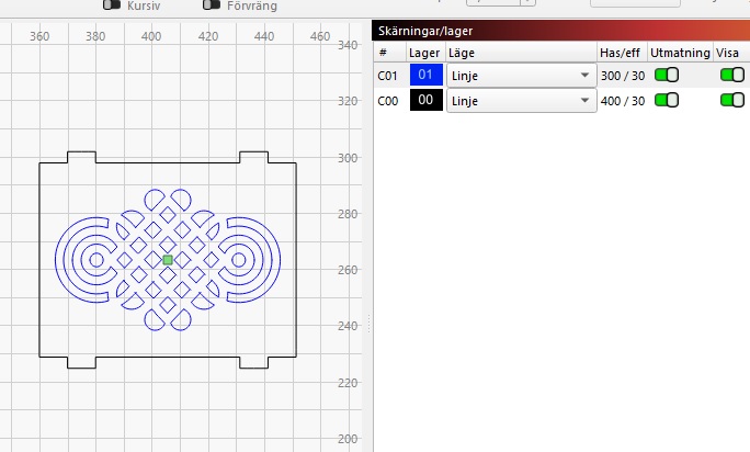

Here comes another problem.
How do I get the image to cut out the blue
part first, and the black edge last ?
Every single time I try, it starts to
cut out the edge first.
Go to Lightburn Optimize settings and make sure “Order by Layer” is selected.
In Optimization Settings, turn on Cut inner shapes first.
Note the caveat:
The outer shape must be closed in order for this optimization to apply.
Click on the C00 line in cuts and layers, drag blue line below black line. All blue will cut before black.
I was under the impression that the layer color meant nothing as far as cut order..?
That’s correct, it doesn’t matter what color it is, but the last one will be processed last.
