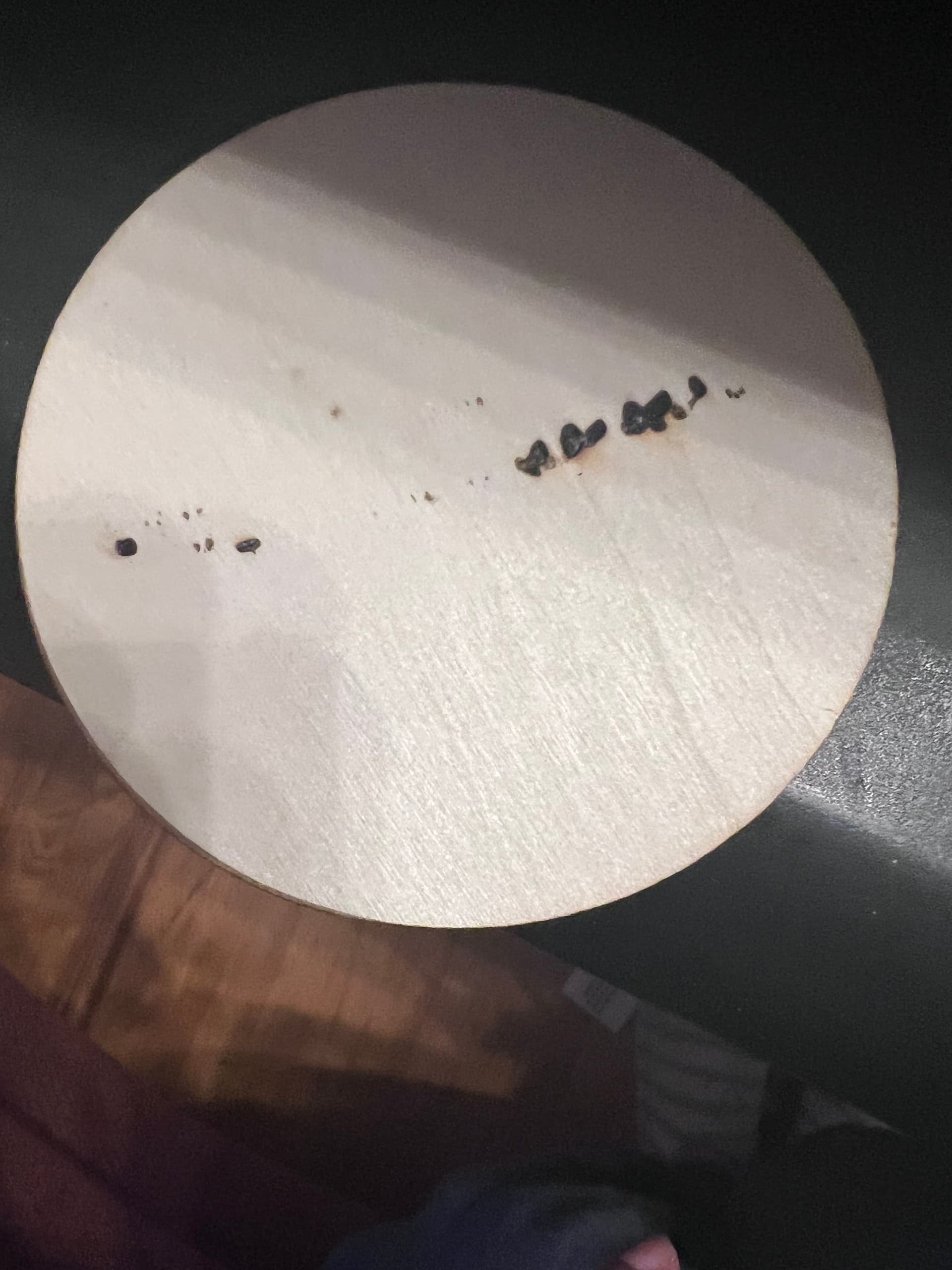

The only connection I had to make was plugging in the laser using the Axis connector. I create a name in LightBurn with the dimensions of 3.57 x 1.26 inches. When engrave this name, the width seems correct, but the height is about a quarter inch slanted. Sometimes it’s just a single line where you can’t make out what it says. Can someone help me? And was it worth it to trade out the lasers? I was hoping for a deeper cutting one.

Can you take picture of your project result?

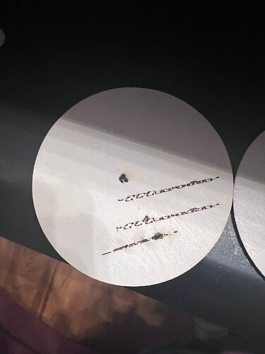

Here are a few pictures of what the output looks like.

Can you make a square say 50mm and see what it looks like?
Ok. I will try that now. And yes, it’s the same power supply. I’m still using the TwoTrees motherboard. There is one that came with the Laser Tree, but I wasn’t sure how to connect it.

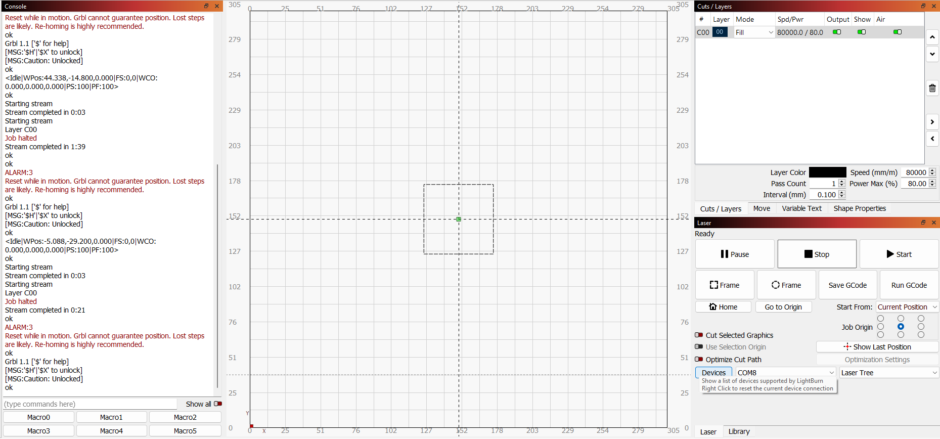

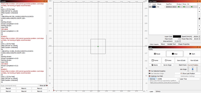

Now it won’t engrave nor cut. I’ve uploaded a screenshot of my settings.

To get deeper engraving:
Check focus length and then run more passes and or cross hatch.
This is great. I am getting it to engrave but the sizing is still a problem. The width of the image is fine, but the height is not. I looks squished and slanted.
Can you burn that square and show what it looks like.
