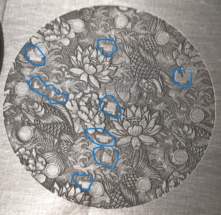

Strange artifacts appear. Here is an image engraved in lightburn in grayscale (not to be confused with 3D), the lower image is engraved in EZCAD.
 ![image](https://forum.lightburnsoftware.com/uploads/default/original/3X/0/0/000d3aecc9b4f382ab223875849988436ec66de8.jpeg)
 ![image](https://forum.lightburnsoftware.com/uploads/default/original/3X/c/a/ca6f2c39e17fa41a8a351dee0e13a0cb147cdc03.jpeg)
When engraving this design in light burn using a 3D slicer, the problem is the same. But it takes much more time.
In the 3D modeling program everything also looks ok
 ![image](https://forum.lightburnsoftware.com/uploads/default/original/3X/e/3/e38c5b825c87cfd3b31c64a4fe871d9af1fb658b.jpeg)
**How can I solve this problem with gray gradation?**
**Thank you all in advance for your help**

Ah… the curious case of the uninvited Tetris blocks!
It looks like many of the darker areas such as in the mouth of the fish and the insides of the circles have been skipped over.
 ![image](https://forum.lightburnsoftware.com/uploads/default/original/3X/3/2/32a6b93e8d3463eebe93a17a1516d5cddc8a1721.png)
Did you create a PNG heightmap image to use with grayscale mode? - what does that image look like?
I’m also not sure how fast your machine can vary the power intensity at high speed in a single sweep of the beam, perhaps the power-change-responsiveness lessens significantly once you exceed a certain speed/power threshold? Maybe try reducing your speed by 1/3 and lowering min and max power slightly as well and see if that makes any difference?

These all appear to be artifacts from saving the file as a relatively low-quality JPG, instead of using PNG, which is lossless.
For example, zooming in above the flower, near the top middle, you can see these blocks where the compression has made it completely smooth:
 ![image](https://forum.lightburnsoftware.com/uploads/default/original/3X/6/e/6e2079f4a096022359038748db998cdcc463feb5.jpeg)
Here’s the same image, but with the problem area outlined in red:
 ![image](https://forum.lightburnsoftware.com/uploads/default/original/3X/b/7/b7479d04d39fa8630c01aff6ddc34502d1a5ed5f.jpeg)

I think the problem is that LightBurn is actually engraving these as single, continuous lines, because they’re all the same brightness level, and EZCad looks to be engraving them with variation, which is weird because there is no variation there in the source image - it’s all a single color. It’s as though EZCad added some noise:
 ![image](https://forum.lightburnsoftware.com/uploads/default/original/3X/6/9/69397528a079eed3c432ccdd69551c7f16fd4736.png)
The simplest way for you to “fix” this would likely be to add some random noise to the image (+/- 2 brightness levels, probably) and then save it as a PNG, not a JPG, so it doesn’t get filtered out.
