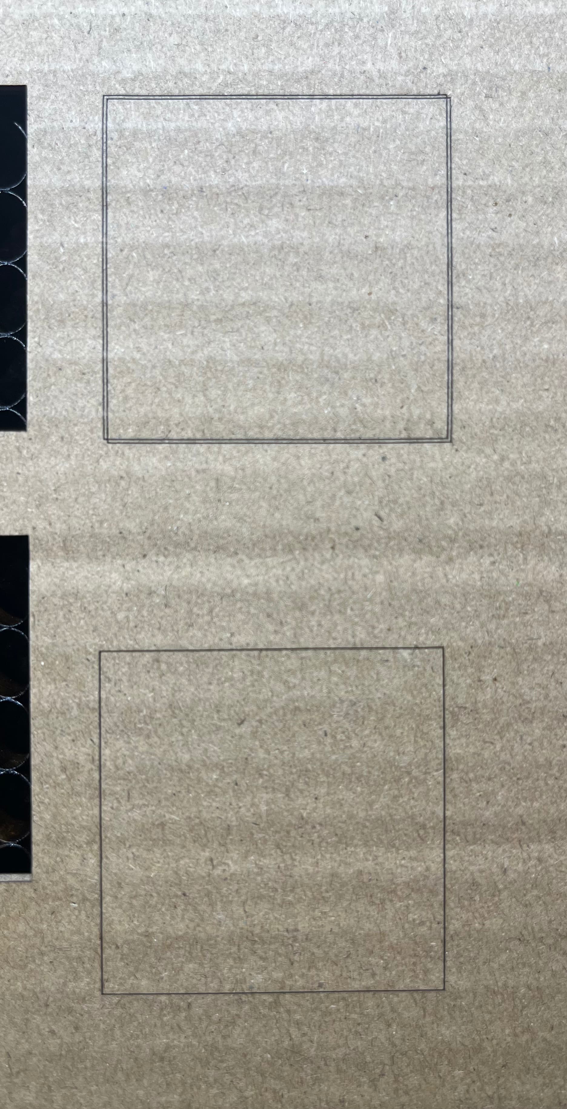

Hey guys, I have an Acmer P3 48W diode laser. I’m having a problem where after homing (with limit switches) and running a job straight from that position, the lasers moves to the top middle of the bed after completing the job (which is fine I like it). However, if I then try and repeat that job it’s ever so slightly misaligned.
The weird thing is - is that if I move the laser to any random position (via the move panel) after initially homing and then run a job, I can repeat it accurately and consistently from the end position.

Cannot tell from your description, but it sounds like the controller is powering down the stepper motors. If this is true, cable tension could pill the gantry or trolley a bit.
$1=255 may keep the steppers powered up. Any other value is the shut-off delay on milliseconds.

This is an indication of play in your machine. To verify, scale this file proportionately to fit your laser bed and run it at high speed with optomizations turned off at just enough power to get a good mark on cardboard. Post a photo of the results so we can confer with you.

So the top square is ran straight after homing and then again from the end position (top middle)
The bottom square was ran from the end position and then again from the end position. As you can see it’s perfectly aligned.
Weird.
The mismatched squares after homing tell you that the Home position is not repeatable, perhaps due to a cable snagging or another mechanical issue.
The overlaid squares from the End position tell you that the Home position mechanical problem doesn’t happen elsewhere.
You must find and fix the mechanical issue affecting the Home position.

It would seem that setting $1 to 255 has resolved this issue. Is there any downside to doing this?
