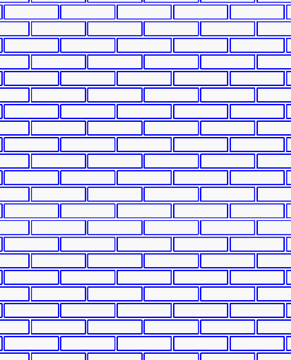

I designed a brick wall in HO scale. The bricks are about .02x.09” with .002 spacing to represent mortar lines. For some reason, when I engrave a wall section, the laser engraves it twice. It’ll engrave all the bricks and start the process all over again. I have it set for just a single pass. Is there a setting I’m missing somewhere? Here’s a segment of a wall section:
Thanks for any help anyone has.

He uploaded the GCode output (text) file to the laser instead of the Lightburn (.lbrn2) design file. The .GC file is just raw commands to the laser. It does not contain the Lightburn settings information.

I think I fixed the problem. If I turned off the optimise cut path setting, it would take 4-5 hours to do everything and would cut everything twice. Still don’t know why it would do that, but using the optimize cut path reduced the time to 45 minutes and cut everything just once.
