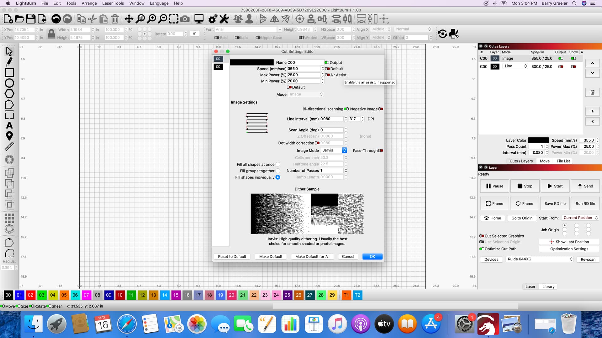

Every time I engrave a photo I end up with a vertical line to the left side and right side of the dog’s head. I have the speed set at 400mm/sec and the power at 25 percent using Jarvis, Stucki, and Dither on a Thunder Laser, Nova 24, sixty watt laser. I have used DPI of 600, 400 and 300 but end up with the same results. I have used Baltic Birch and Maple and end up with the same results. I have deleted the file in Lightburn and the Ruida Controller and started over but end up with the same results. Also, as you can see from the attached photo it is not clear and sharp. I am using Lightburn V1.1.03 on a Mac computer.
Any idea what I am doing wrong?

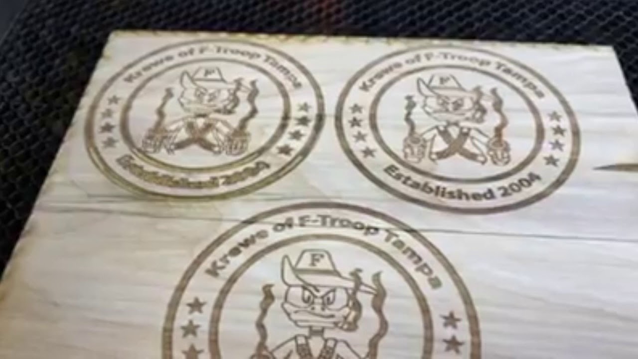

It appears that the Scanning Offset is out of adjustment.
> **[Scanning Offset Adjustment - LightBurn Software Documentation](https://docs.lightburnsoftware.com/ScanningOffsetAdjustment.html)**
> Better software for laser cutters.
This may be worth review:
[![](https://img.youtube.com/vi/hMcQtKfDb1k/maxresdefault.jpg "HOW TO.. Lightburn Scanning Offset Adjustment") ](https://www.youtube.com/watch?v=hMcQtKfDb1k)

It looks like you may have entered your scanning offset values in inches instead of mm. Did you set the software to use inches as your units before you entered the scanning offsets? That’s a very common mistake - Thunder ships the values in millimeters.

Go to Edit \> Device Settings, and take a screen shot of that window. Post it here so I can have a look.

![Screen Shot 2022-05-19 at 7.22.08 PM](https://forum.lightburnsoftware.com/uploads/default/original/3X/5/2/52c2cb13fbf52cdbb251b8a41f867b5d0650ae79.jpeg)

![Screen Shot 2022-05-16 at 3.04.10 PM](https://forum.lightburnsoftware.com/uploads/default/original/3X/5/7/57a7ece9c0ebb59dabc4666be645496734d35a33.jpeg)
 ![Screen Shot 2022-05-16 at 3.03.42 PM](https://forum.lightburnsoftware.com/uploads/default/original/3X/9/6/96d8fddbdcc3c29ae136a467a03dcd0d589f8cde.jpeg)

![image](https://forum.lightburnsoftware.com/uploads/default/original/3X/d/f/df457905e3c3845bb79e20b08e8fa775d5b34477.png)
These numbers are _huge_ for scanning offsets. a 2mm shift at 2mm/sec, and an 8mm shift at 400? I suspect you have a Thunder Laser, switched LightBurn to inches, then entered the values on the scanning offset card, which are provided in mm, not inches. Entering them when in inch mode would make them 25 times larger than they shouldbe.

That worked, thanks! What I don’t understand however, is since Lightburn converts inches to millimeters and millimeters to inches what difference does it make if the measurements for the photo of the dog are in inches instead of millimeters?
<div class="post-metadata">
**Post date:** [June 8, 2022, 10:34pm UTC](https://forum.lightburnsoftware.com/t/problem-with-photo-engraving/66695/11 "2022-06-08T22:34:04Z")
</div>
You ‘machine’ speaks in ‘units’ not inches or mm. So both of them have to know what ‘units’ they are speaking in.
Make sense?
