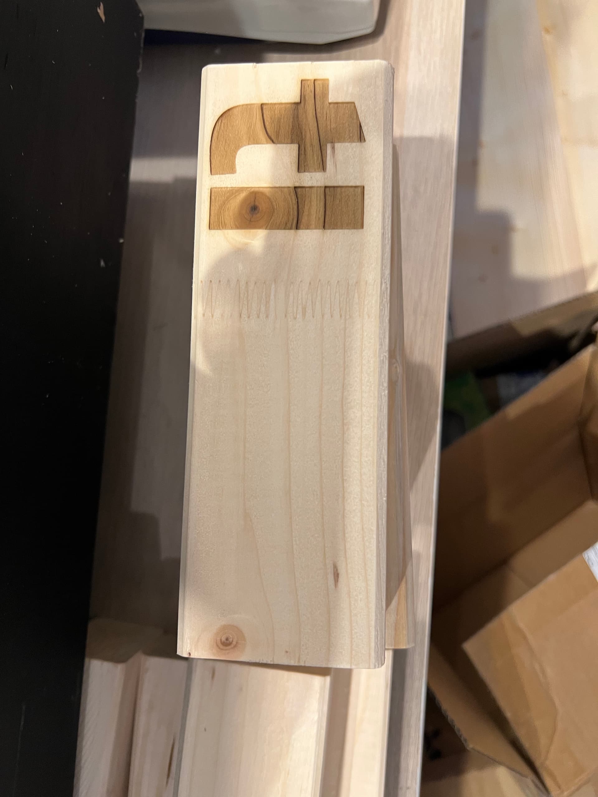

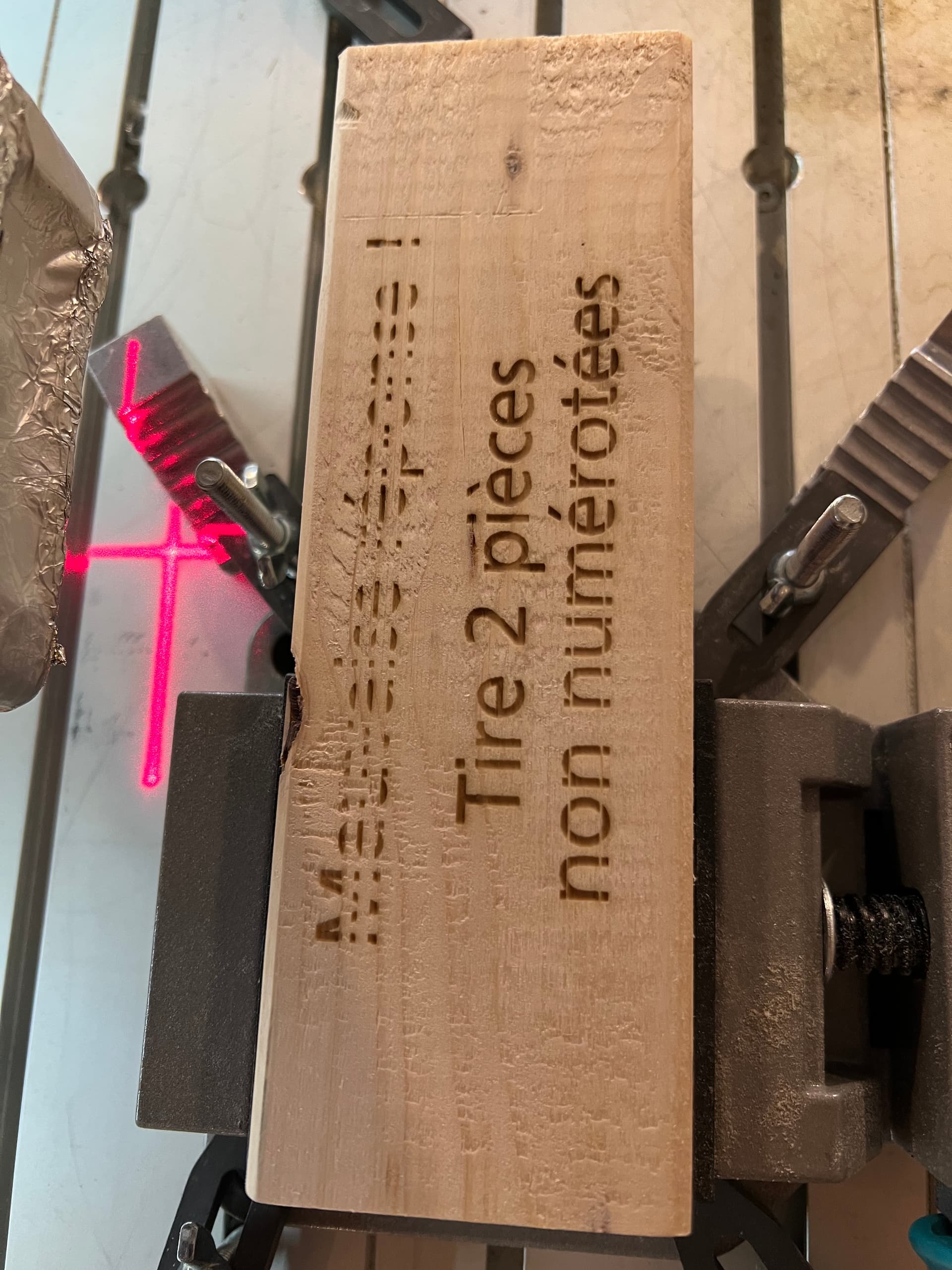

I have a problem when I write text into Lightburn : Sometimes only the top and bottom of the text is being converted into gcode and the middle the laser move but there are no burn order so the text is not printed.
I cannot figure out what I’m doing wrong as some text is burned correctly and some not. If I use the option peint pot it work well but it’s slow …
Any idea why it’s doing that?

Here is the file :
logo tl.lbrn2 (68,3 Ko)
And the result:
As you can see the bottom text is burn correctly where the top one is not burn in the middle of text (and the gcode has only zero power line) the logo (which come from a svg) is also burn correctly.
Let me know if you need more info ?
Thank you very much for your help.
Antoine
This looks like there is a mechanical / electrical issue with the laser. Check the preview of LB, I guess the project is sent as it should?
