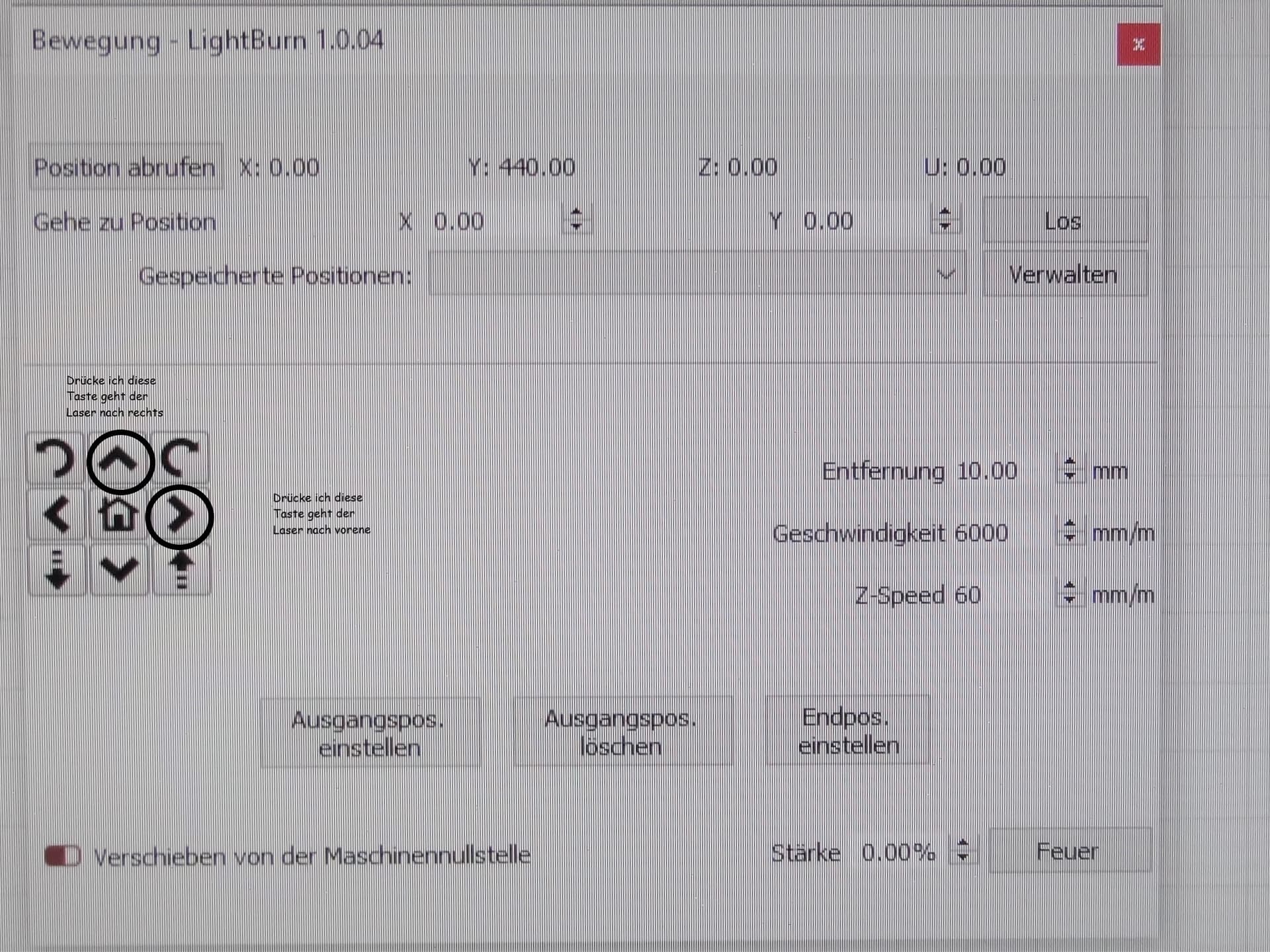

Probleme mit Bewegungstasten

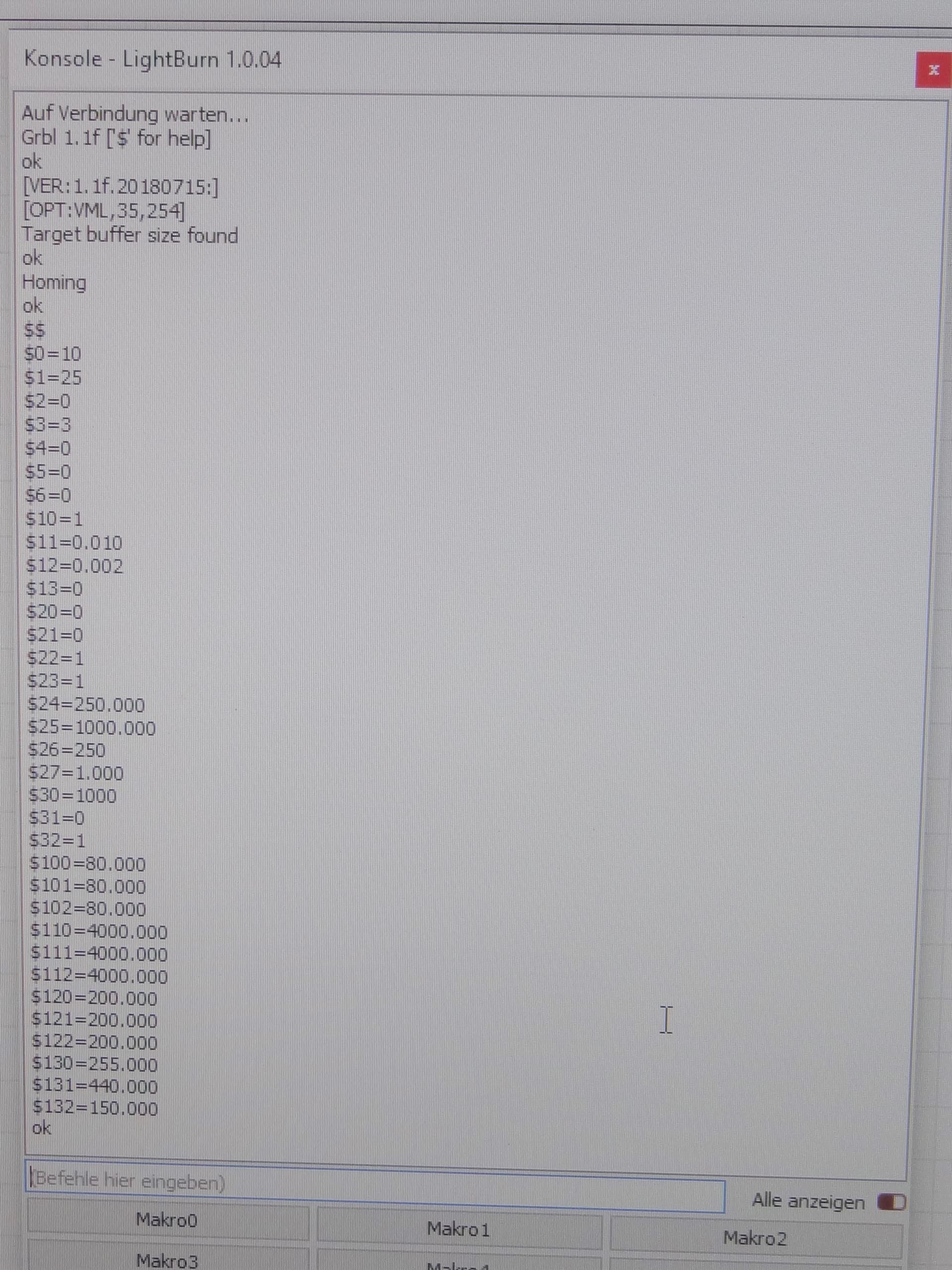

Ich hoffe mit Hilfe dieser Fotos kann mir jemand helfen. Schon mal Danke!!!
I may be mistaken but isn’t the origin for your laser (Neje Master 2s plus) in the upper-left? Try changing that in Edit->Device Settings and see if this fixes your problem.
Also, where did you get your device dimensions of 415x250mm? I believe they should be 255x400mm for that machine unless you have modified it. So you may need to swap width and height and correct the numbers. Smaller numbers should not prevent you from using your machine but you won’t be able to use your whole space. Bigger numbers could end up crashing your machine.
Vielen Dank!!! Sowie es aussieht funktioniert es jetzt. Nochmal Dankeschön!!!
