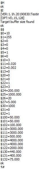

Hello, I work with Arduino and GRBL 1.1h. This works well with LaserGRBL. I want to switch to LightBurn, but I’m having problems.
I installed Lightburn and set the basic data.
My work area is X440 x Y400mm, the limit switches are on the front left. That should also be the starting position.
If I now switch on LB, the homing is done correctly and the laser is moved 5mm (as set in GRBL) from the limit switches. When retrieving the coordinates, X-435 and Y-395 will be displayed. The entire navigation plays in the minus area.
What am I doing wrong?
And how can I correct this?
Greetings Manfred

Can you run these commands in Console and return output?
$H
$I
Note that the first command will home your machine so be prepared for it.
Ausgabe
Homing is OK
Where did you get the firmware for the Arduino? Normally I’d expect it to zero-out after homing but that’s not the case here. And not only that it’s put you in negative workspace. I don’t believe the default build from GRBL does this so I’m curious.
You can resolve this by introducing a work offset. Run these commands in Console:
G10 L2 P1 X-435 Y-395
$10=0
Rehome and then retest please.
