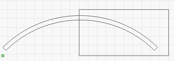

Draw a rectangle around the part to discard:
Select the arc, then Shift + Select the rectangle, and click ‘Boolean Difference’ to subtract the rectangle from the arc:
