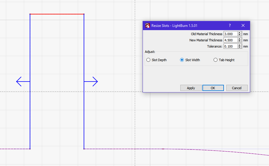

hello, does anyone want to see why I cannot increase these slots from 3 to 4.5 mm
I can’t figure it out with the explanation I received in another topic
(Resize slots in section - #8 by bernd.dk)
greetings Ronald
The slots and tabs need to be constructed from straight lines. In your example file these are splines. Change these to lines with the node edit tool and it works.
Before:
After changing to lines the resize slots tool will work:

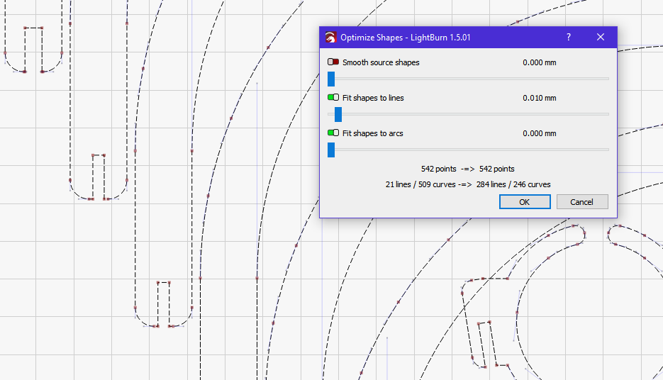

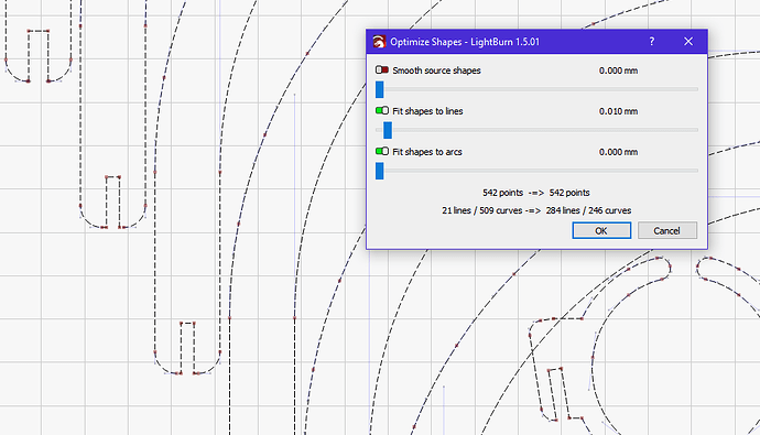

EDIT:
Instead of using the node edit tool you could use the ‘Optimize selected shapes’ tool to convert them all at once before performing the resize.
