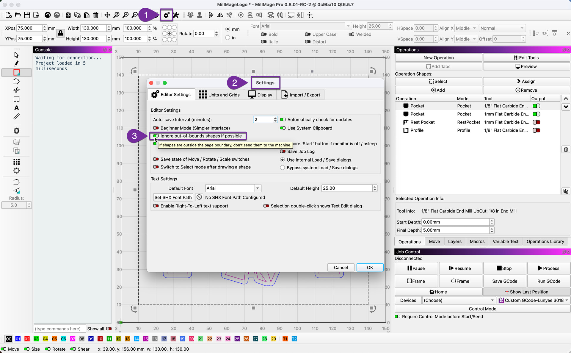

I’m attempting to use a routing tool to bevel along a path which in places follows the exact edge of a pre-cut, 6.75mm thickness acrylic workpiece. Because the path is not closed I must use a profile with ‘along the line’ selected. I must also (I think) offset the line position beyond the outside edge of the workpiece by a distance equivalent to the minimum cutting radius of the tool, and accomplish the cut in a single pass, with the depth set such that the z coordinate of the minimum radius of the cut is at at height -3.335 mm (i.e. half the thickness of the workpiece. ) I also need to lead into the cut from the outside, which puts me further outside the edge of the workpiece. I can actually specify this in the software, but it won’t allow me to preview it or generate gcode. Is there an alternative way to do this which I can use?
Look in the main settings - there should be a toggle to “discard out of bounds shapes” or similar. If you disable that, it should let those through.

Thanks Oz – That worked – it did exactly what I was asking for.
