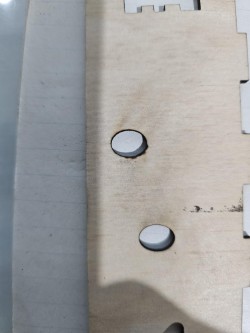

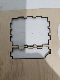

I have a Atomstack A70 max and lighburn is cutting ovals and not circles and also not cutting perfect squares.I have researched this issue and it says there is a issues with the machine having loose equipment. I have reassembled my Atomstack thoroughly inspecting that all the parts are fitting correctly and all bolts etc are tight but the issue still persist. I have also have a brand new A70 and have thoroughly set this one up and the same issue persists has anybody found a solution. I think there is an issue with Lightburn programming.
The issue seems to be in the vertical plain.

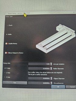

Check to make sure you do not have the rotary enabled
I have have checked this a number time and it has been disengaged. any other suggestions??

I, same as @thelmuth , see nothing wonky about your settings. @baricl1317 Questioned if you had the rotary enabled. Can you show us a screen shot (WinKey+SHFT+S) of the Rotary Settings window?
as requested
After what I’ve read and seen here, I’ll add the following:
  • Do both the bridge and the carriage of the laser module slide smoothly, or is one of them much more rigid than the other?
  • If you send it to engrave a line of 200mm (both vertically and horizontally), is the displacement exactly 200mm, or does it differ?
