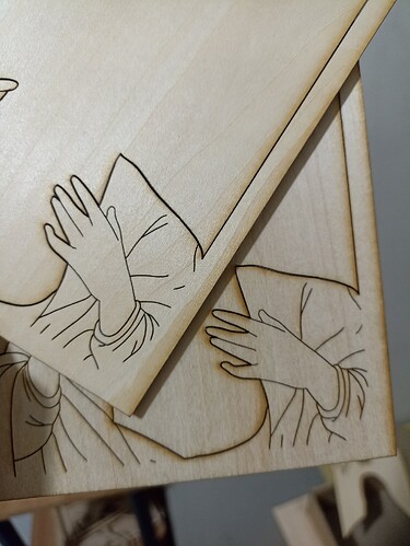

Protective lens (orange lens) is stuck and cant clean
Hello, I post it here in Lightburn as I have no replies in reddit and fb pages. I have a problem with my Sculpfun S9 laser. The laser dot seems to be thicker than it was originally. I wanted to clean my laser head but the protective lens (orange lens) is stuck, I assume it is because from the resin of the wood from burning. Any tips on how to pull it out? Here is a sample of cuts weeks before and now.
EDIT: I have unscrewed the screws before attempting to remove the lens.
If it’s the round one looks like it’s held in with allen screws.
oh yeah i forgot to mention i have unscrewed the screws as well
Maybe try soaking with alcohol.
Many of these plastics are susceptible to solvents. Alcohol is a solvent with acrylic… Be wary.
It’s sometimes very difficult to remove it, but with applying enough force, it usually works. A lot of force, wiggling and patience might be needed. :slight_smile:
