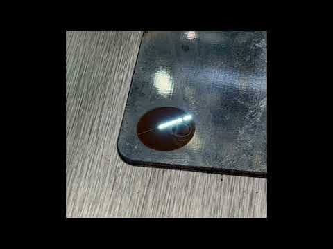

I’m sorry. When we set the number of passages of cleaning layers in 3D mode, the laser cleans only the layer that was engraved. If I put every 3rd pass, the laser will clean the 3rd layer, then the 6th, then the 9th. But you need the laser to clean the 1st layer, the largest layer. It turns out that if I put every 3rd cleaning pass, the laser should engrave 1-2-3 layer and then clean the 1st, then 4-5-6 engrave, clean the 1st. Lightburn also successfully engraves in 3D mode with automatic angle rotation! I can send video of comparison.
I thought I was properly accounting for this - the code attempted to do this properly, but I got the math backwards. I’m correcting this now.
I do not see how this can be true, as the code is hard wired to do 90 degree passes. If you set 3DSlice mode to run a low number of passes, and then globally ran the cut multiple times with an auto-advance, that would sort of work. I cannot guarantee the passes will properly align, which is the entire reason we disallow this.
Set passes in clean layer 1 and auto-rotate angle, set power and over settings like for engraving. But in engraving set power 0 and high speed. And the you can see that slices with auto-rotate angle of hatch. I can send video to you tomorrow. In my first message in this topic you can see result, perfectly 3d

The clean layer will auto rotate, yes, but not the image engraving. Since the cleaning layers are not intended to cut into the metal, slight misalignment there is acceptable.

I’m sending files for testing, I’m also sending a video that auto-rotate the angle works very well for 3D

So, what you’ve done here is just used the cleaning pass to do your engraving, instead of the image pass.
Yes, it will run, but as I’ve said, the layers will shift relative to each other because rotation resamples the image, and the library we use for it doesn’t perfectly align the outputs. The amount of shift is likely very small because of the tiny line interval, but using larger interval values will make it more apparent.

Hi, you have released an update. Checked the operation of the cleaning mode in 3D, still cleans as before.((( p.s. maybe i dont understand new features.
