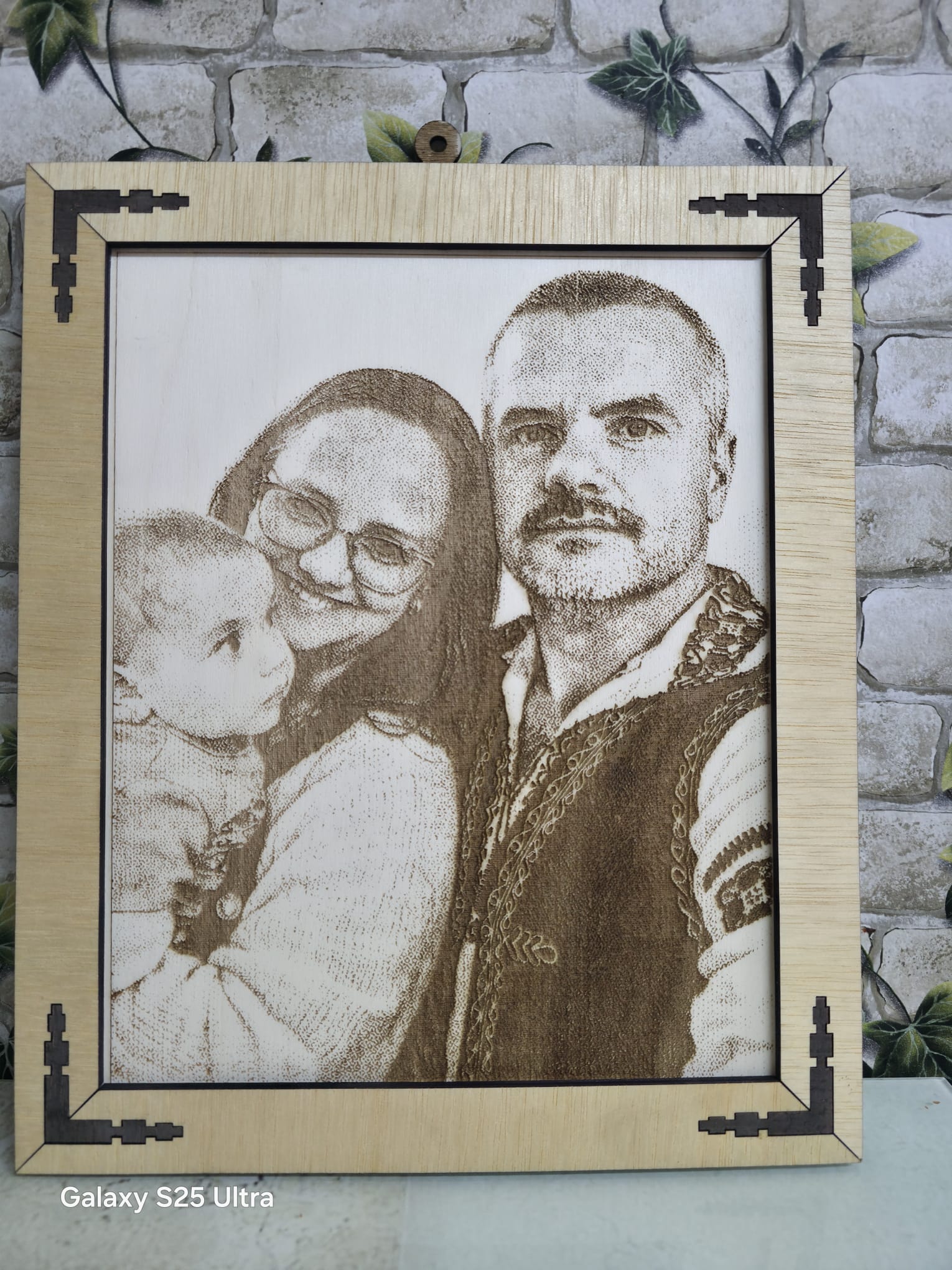

This is one of my attempts. I’m not satisfied with the detail and contrast.
I used Jarvis, 317 DPI, 4000 mm/min, 45% power.
What would you improve?

I processed the image in LightBurn on 3mm poplar plywood (20W diode).
My main issue is low contrast and loss of fine details in faces.
Would you recommend adjusting the image (levels/gamma) before importing, or focusing more on LightBurn settings like DPI and power?

this part ill tell you what i see is wrong with the photo from the engraving , these are things that need addressing prior to bringing into LB
photo used is too small looking at the patterns on neck id say some where around the 80KB in size
so will be really hard to get a good image from that low quality.
i wont work with an original photo from a phone under 2 mb
this is order of how id alter your photo
1st drop contrast
shadows need increasing to remove black mass in jacket and give women hair definition increase till black becomes grey than back off a tad
highlights decreasing till they disappear then increase till they just come back
sharpen to bring more lines into women’s jersey but keep eye on faces as you tweak don’t want an over sharp face
drop saturation a tad , increase exposure contrast may need a slight tweak

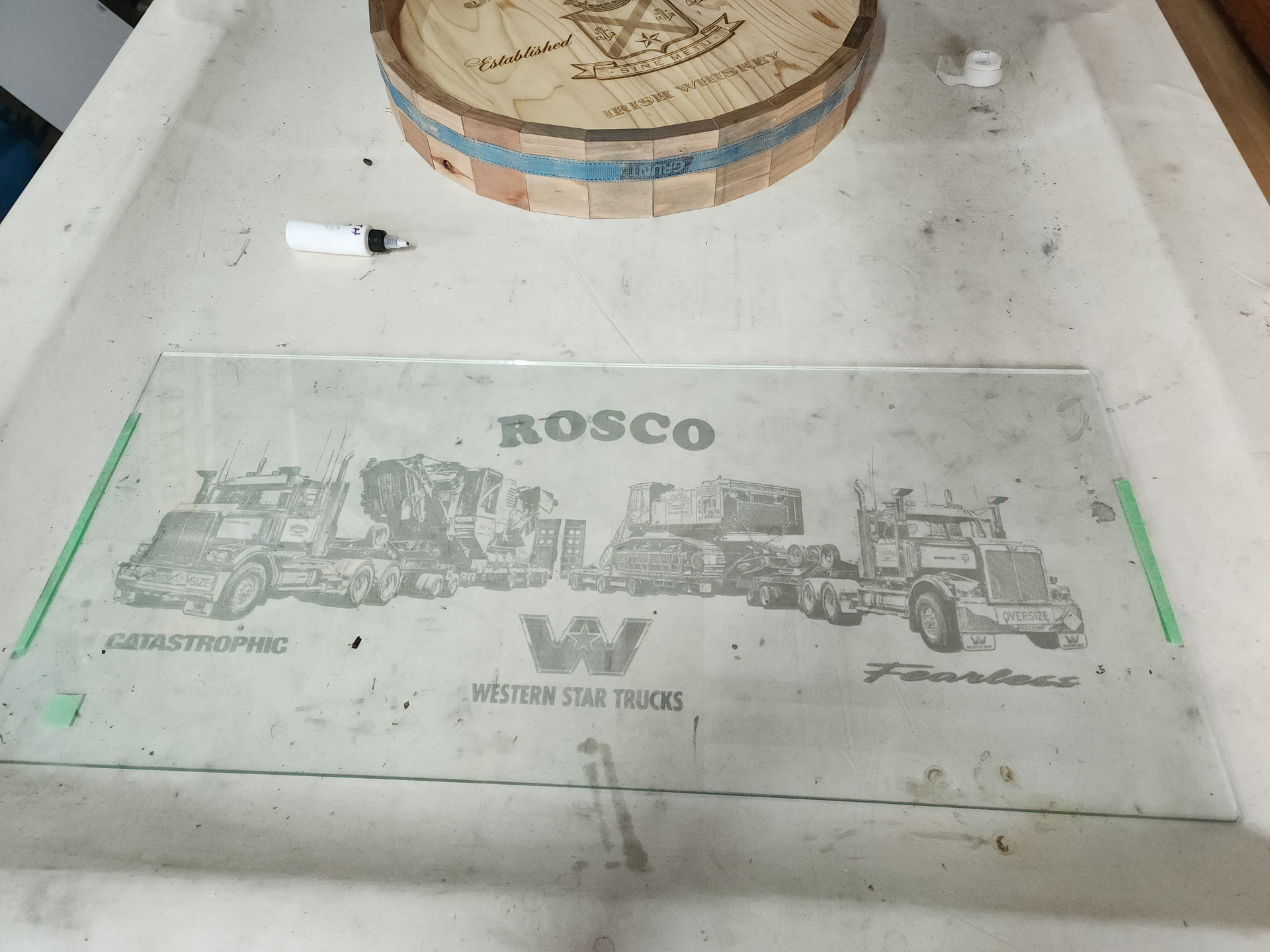

one ive done look closely at how black some of the machine areas are in photos than look at detail in glass, that is to date the most time consuming job , over 20 pain staking hrs of editing and if remember over 4 hrs engraving ,ive only owned a laser for 2 yrs
