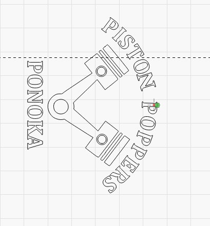

I have text and picture set up in Lightburn to position and start at the top center of picture. When I start the engrave it rotates and starts to engrave and the engraving is NOT centered properly where i want it….how do I correct this? I position the laser so that it is at the green start square. But when it engraves, the center is no where near were I want it, I make a mark on a cup and aligne laser with the mark.
Make sure to enable „cut selected graphics only“ and „use selection origin“. Does it happen then as well?
