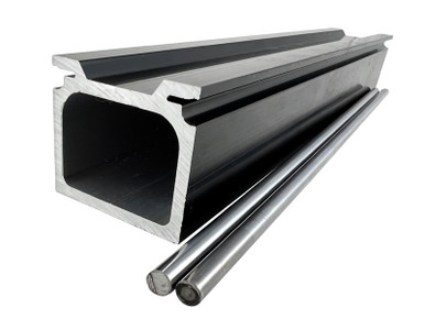

Most people would use the industrial linear rails like these:
But I would recommend a different path- the wheels on external rod running surfaces:
The first type, those 4 carriages have a lubricated ball bearing circuit on each side. The bearings actually roll down the rail, so exposure to smoke and crud can foul the circuits. They have wipers on the ends to clean the rail and a needle port to inject fresh lubrication, but contamination is still a problem. And you can’t adjust a preload from one side to the other, so it can rock around a tiny bit which may be a problem for alignment.
The second type there uses wheels with conventional sealed bearings with a “U” shaped outer diameter. There are cams for adjusting preload. They don’t run the ball bearings on the exposed rail, so it avoids that contamination issue.
Also, they can travel faster. The first type has limits because those bearings can only go through the circuit so fast. A conventional bearing also has a cage that keeps the balls from contacting each other- remember, the adjacent bearing surfaces are traveling in opposite directions where they’d touch. And they would also impact each other all the time. There’s a hard limit where the speed of sound in the bearing material is exceeded and the bearing will be destroyed pretty much instantly. That’s high limit actually, but they do accelerate wear quite a bit when run at higher speeds.
For the gantry, this should be lighter, too. The first option has a thick solid steel rectangle cross section- it’s heavy, but not rigid enough to be the gantry. So you’d need to bolt it to an aluminum square tube and the combined weight is high. The second option is a hollow aluminum box that is definitely big enough to be the gantry all by itself
