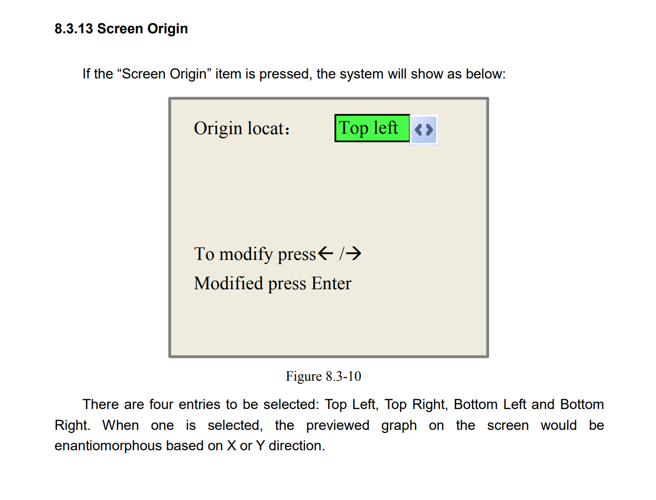

Hi guys. Couple of questions. We have a boss laser and have made the top right corner or origin. When we slide say a cutting board in the top right corner and send file to the machine it is actually flipping the design over and down and reversing the text. Thoughts on that?

Usually, you don’t get to choose your machine’s homing origin, which is set by the location of the homing hardware. On most Boss Laser laser cutters, it is usually the back-right corner, but you should check that it is the location of the switches.
Often, Boss Lasers use Ruida-based controllers, and sometimes the keypad can be flipped. You can correct this (or check it) by using the keypad Z/U key, then navigating to Screen Origin and setting this to the correct orientation.
You might need to try a few orientations to get it right.
Boss Manual Page 35 https://bosslaser.com/wp-content/uploads/2024/06/Download-Laser-WORKS-V8-Hardware-Guide.pdf?srsltid=AfmBOooSstjGD9EK28OczPydRYg3EgQL8agzKZzVBY29IEyQMJpKrY7e
