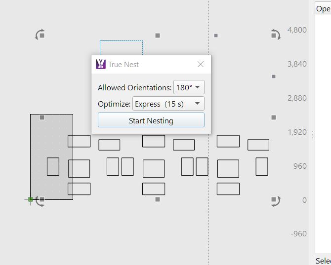

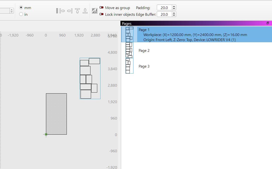

just trying true nest, these are my setting

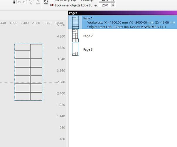

20 mm pad and 20mm buff i watch it go through its process
but what i end up with is a lot of wasted material spread over 3 sheets ?
if i use quick nest , it optimizes it neatly and uses only 2 and a bit sheets
what am i missing, my thinking is true nest would optimize better than quick nest

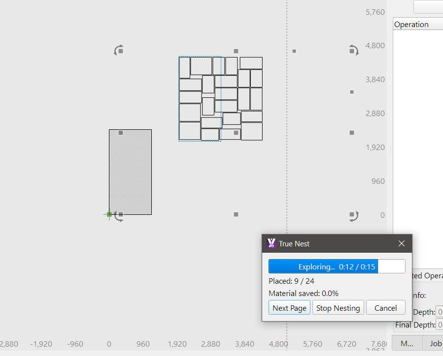

I tried the most extensive nesting setting and it would go to 10 pcs, then continue on instead of moving to the next, in the first page. Final result was 3 pages no matter what I tried.
The Nest, Quick Nest button immediately put 13 shapes in the first box and 11 in the second. If I had tried this out first, I would not even have tried the True Nest button.

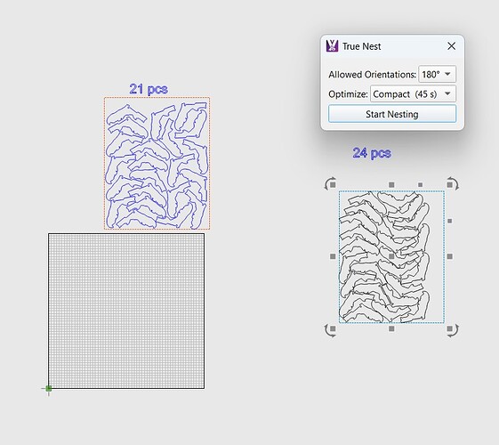

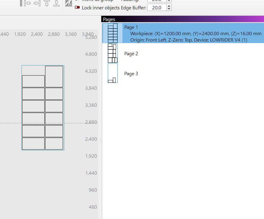

I was curious on how it would handle complex shapes, so I ran a test.

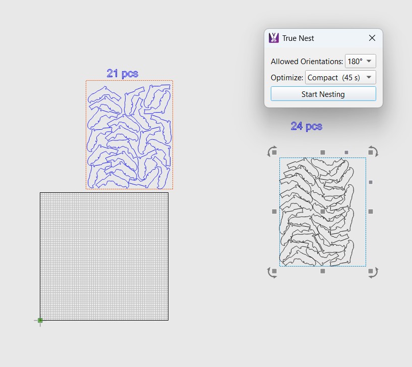

I did my best manual nesting and got 21 pcs to fit. I was pretty proud of myself! Then I tried True Nesting with the settings in the first image. It had 24 objects to manage. As you can see, it was True Nest 1, Mikey 0.

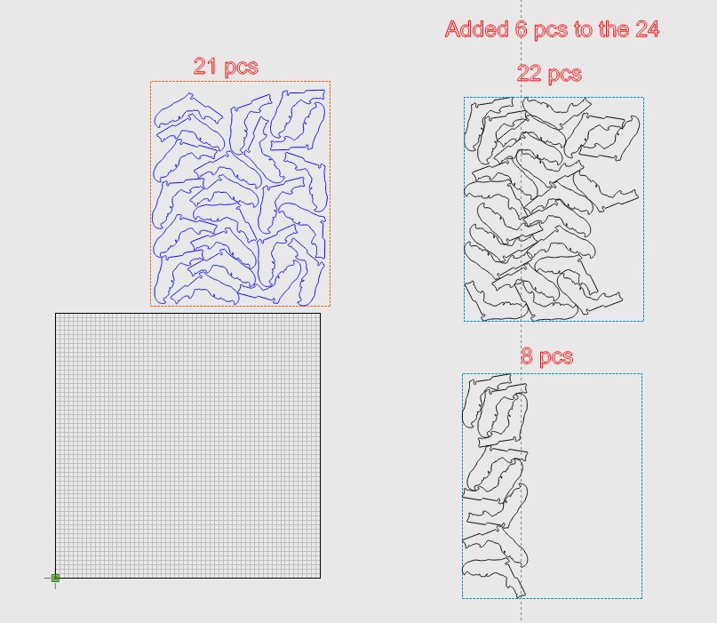

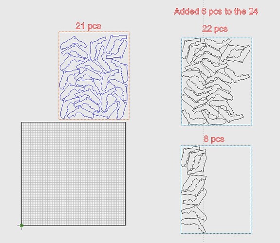

Then I added 6 more objects to see how it would respond, same nesting settings. I have no idea why it only got 22 in the first page when it easily got 24 in there (quickly) the first time. Anyhow, Round #2, True Nest 2, Mikey 0.
Note: If you want to see Pg 2 along with Pg1, CTRL-D does not do it for you. Show Pg 2, Ctrl-C, then CTRL-V, and back to Pg 1 to see both. Quirky!

The strange thing of True Nest is in intermediate steps it places 12 or 13 pieces and end just offering 8 or 9.
Yes, I noticed that too. It would peak out then settle for less on the first Page. Almost like it figures there are leftovers anyhow, so why worry about it.
