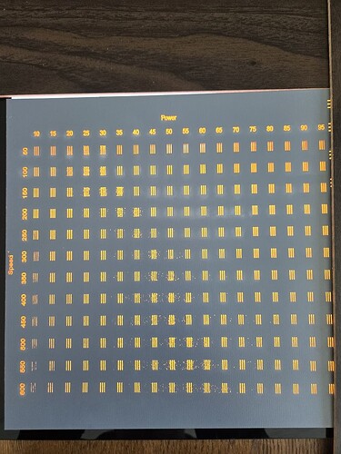

Can anyone help us to understand why we get these random dots that seem to have some correlation between the power and the speed? They are most evident on mirrored acrylic and slate and we are trying to figure out the cause. This is a material test we ran on the mirrored acrylic:
We have seen the lps lase when the signals tell it not to lase… @ednisley has caught this on his scope…
ooh, hey thanks for that, I was searching the incorrect terms. found an old thread Weird dots all over my engraving - #243 by JustAnotherLaserGuy that points to a bad lps. Any ideas if there are any recommendations on replacement lps or any line filtering that can be done?

I found it weird that as the speed increased the power the dots showed up at moved. I figured it was power related but wasn’t sure if it was dirty/EMI related or just bad/cheap LPS.
Guess we need to find a new/better LPS or something else.

I suppose it is possible I just got another bad LPS. For now I will just be stuck using this machine primarily for cutting, or for slow speed engraving (although even lowering the power and speed does still leave some less visible random dots on materials like acrylic). I guess I can’t expect much from a $3k machine

One of the other users (@DougL with a K40) suggested to try it using the analog output of the Ruida instead of using the pwm. I don’t see how this would make a difference, but it’s a cheap attempt to see if it fixes it. You can just swap the wire from LPWM1 to L-AN1 to test his theory.
I thank @DougL for sharing his input.
Ok, I will give that a go and see what happens.
Gave it a shot and unfortunately no change.
I don’t’ know what else to advise… I didn’t think changing from digital to analog would matter, but I’ve been surprised before with this stuff.
I think you’re back to the original issue.
