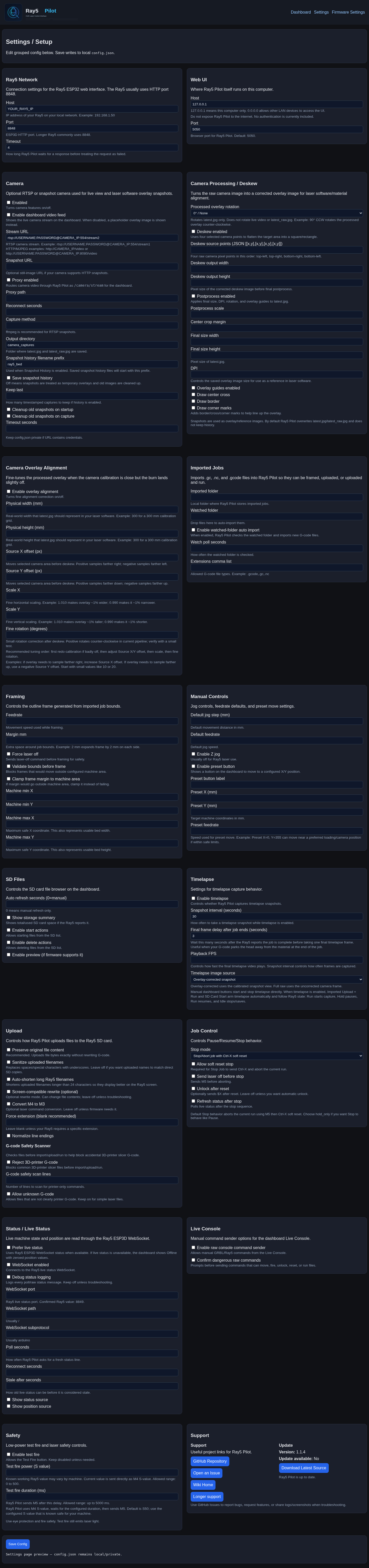

Here are some screen shots!
 ![ray5_dashboard_github_demo](https://forum.lightburnsoftware.com/uploads/default/original/3X/d/9/d9deeca5173814cb6277a3d5209c4cf601fc4939.png)
 ![ray5_settings_github_demo](https://forum.lightburnsoftware.com/uploads/default/original/3X/4/c/4c1567bef8c72e20e1bfef9c1f79aea11c20b97c.jpeg)

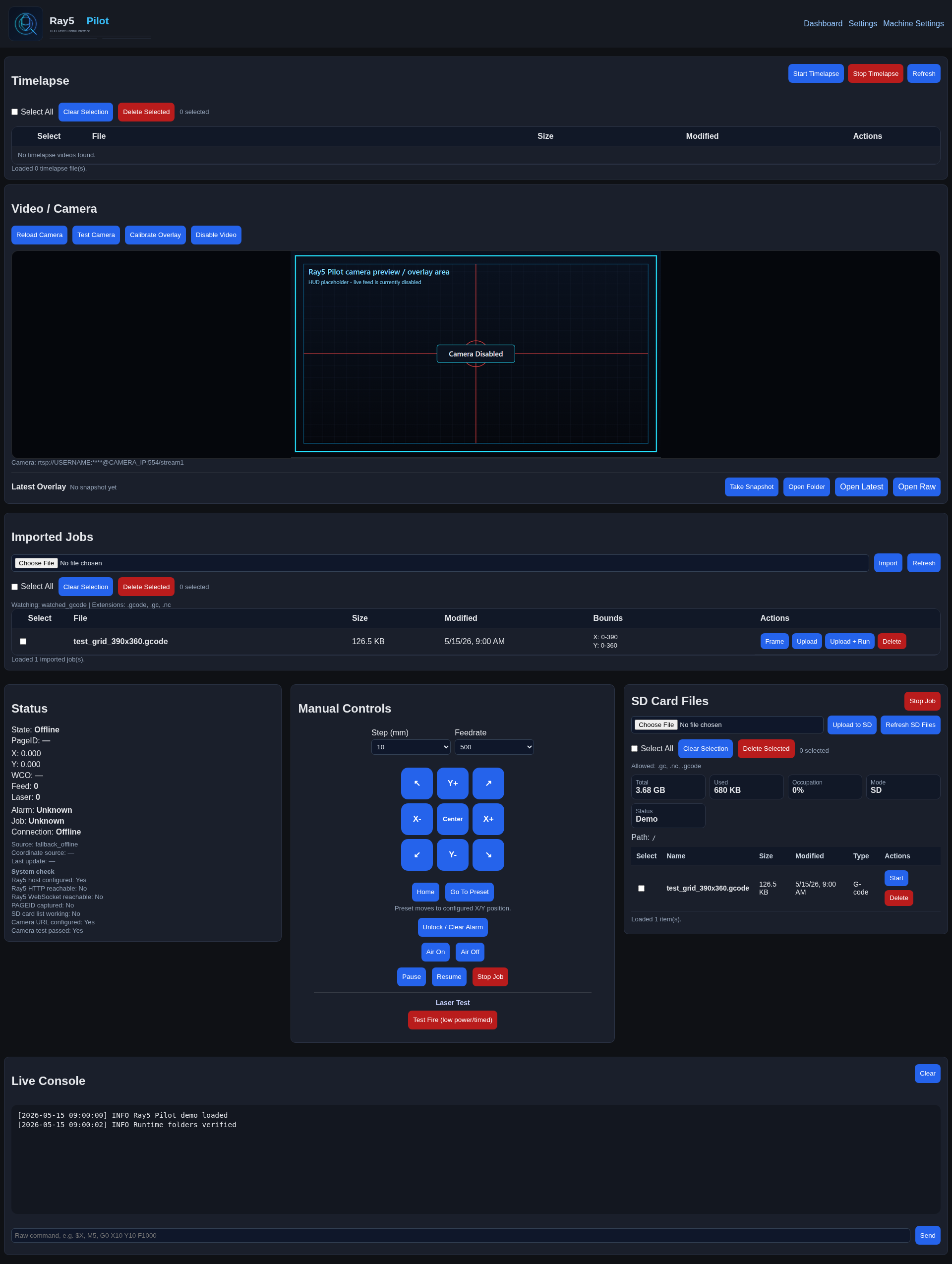

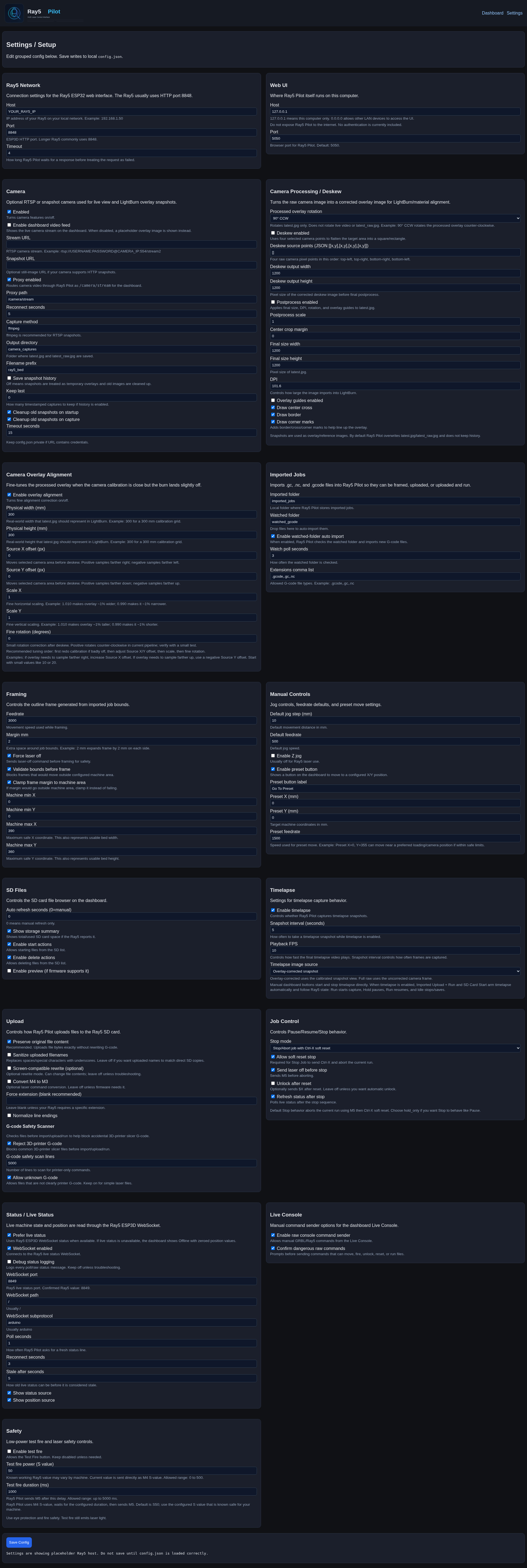

Version 1.0.4 has been released.
**Ray5 Pilot v1.0.4** focuses on file management, timelapse control, camera calibration accuracy, and safer dashboard behavior.
### Highlights
- Added multi-select file management for **Imported Jobs** , including Select All, Clear Selection, selected count, and Delete Selected.
- Added multi-select file management for **SD Card Files** , including Select All, Clear Selection, selected count, and Delete Selected.
- Added a full-width **Timelapse** dashboard card above the Video/Camera card.
- Added Timelapse file listing, multi-select delete, selected count, and per-file Play controls.
- Added Timelapse playback inside the existing top Video/Camera card.
- Added manual **Start Timelapse** and **Stop Timelapse** controls.
- Added automatic Timelapse arming for **Imported Upload + Run** and **SD Card Start** when Timelapse is enabled.
- Added Timelapse Settings controls for enable/disable, snapshot interval, playback FPS, and image source.
- Added Timelapse image source selection for either overlay-corrected snapshots or full raw camera frames.
### Timelapse improvements
- Manual Timelapse mode is now controlled only by the Start/Stop buttons.
- Job Timelapse mode follows Ray5 machine state:
  - `Run` starts capture
  - `Hold` pauses capture
  - `Run` resumes capture
  - `Idle` stops and saves/builds output
- Timelapse capture interval and playback speed are now separate settings.
- Timelapse MP4 generation now uses playback FPS instead of treating the snapshot interval as frame duration.
- Timelapse sessions now use stable session IDs.
- Successful MP4 builds safely remove the matching session frame folder.
- Deleting a Timelapse video also attempts to safely remove the matching session folder.
- Timelapse messages now use one consistent bottom message line in the Timelapse card.
### Camera and calibration fixes
- Fixed embedded Camera Calibration click alignment when the calibration image is resized in the dashboard.
- Fixed camera postprocess scale so values below `1.0` work correctly.
- Improved postprocess scaling by applying source-area scaling before deskew when deskew is enabled.
- Added camera capture locking to reduce race risk between manual snapshots and Timelapse captures.

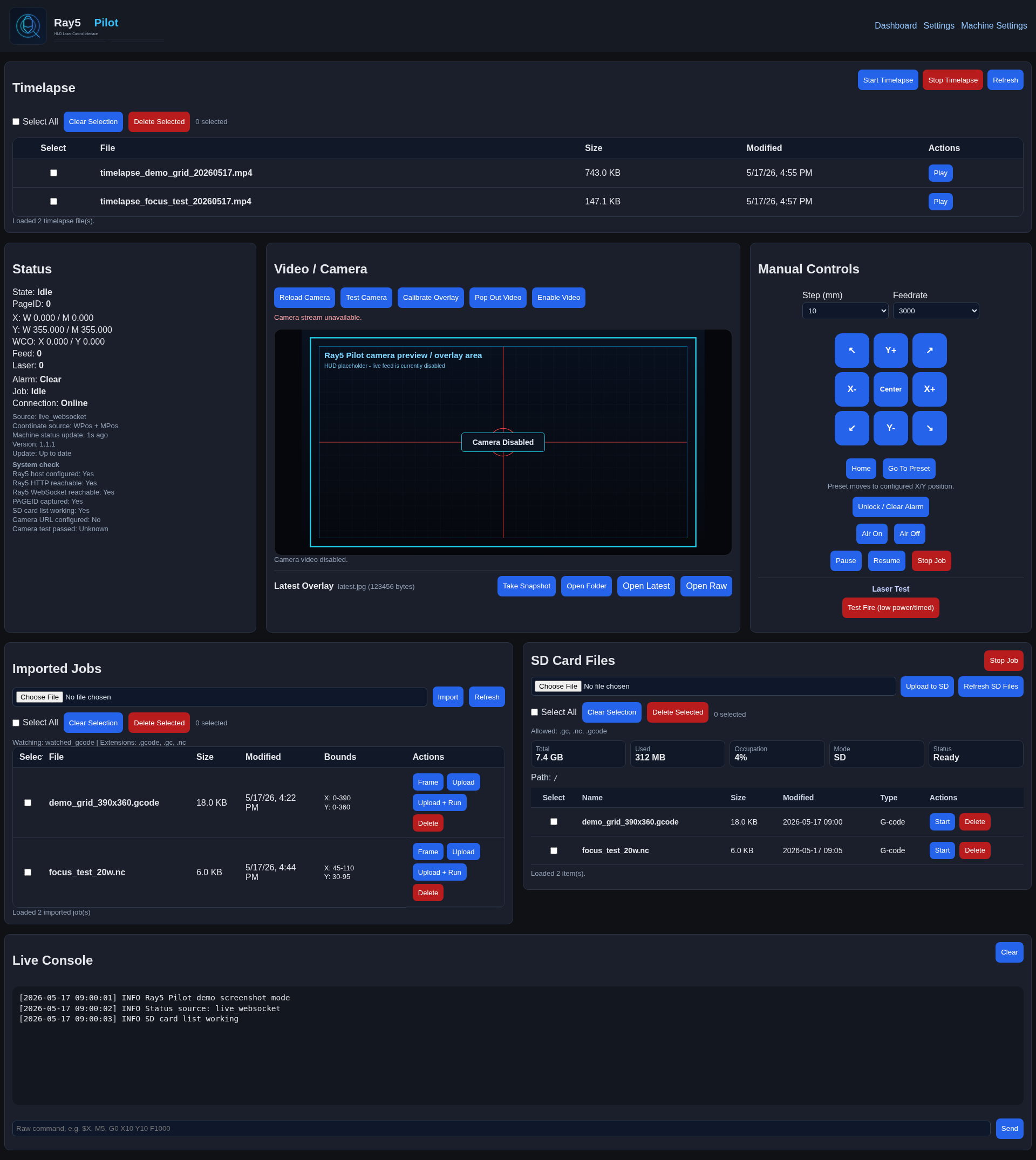

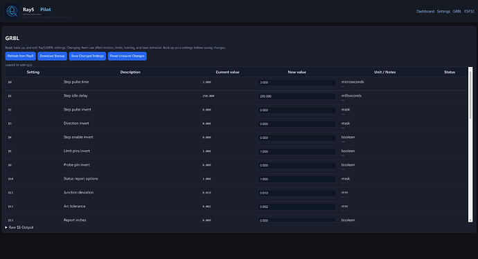

Big release. 1.0.7
### Added
- Added a dedicated **Machine Settings** page for Ray5/GRBL controller settings.
- Added support for reading controller settings with `$`.
- Added automatic parsing of GRBL-style settings such as `$0=10`, `$30=1000`, `$130=400.000`, and similar.
- Added a uniform editable Machine Settings table with setting number, description, current value, new value, unit/notes, and status.
- Added known descriptions and units for common GRBL settings.
- Added **Download Backup** for raw `$` machine settings output.
- Added changed-only Machine Settings save support using safe `$number=value` commands.
- Added strict validation for Machine Settings saves to prevent arbitrary commands or reset commands.
- Added a raw `$` output/debug section to help diagnose devices that return settings asynchronously.
- Added diagonal jog buttons to Manual Controls for all four diagonal directions.
- Added a **Center** button in the jog pad to move the laser head to the configured bed/work-area center.
- Added combined XY jog support so diagonal moves are sent as one jog command instead of two separate axis moves.
### Changed
- Manual Controls now use a full 3x3 jog pad:
  - diagonal jogs in all four corners
  - X/Y jogs on the sides
  - Center button in the middle
- The previous center Home button was moved below the jog pad.
- Home and Go To Preset now sit together in a centered row below the jog pad.
- The preset helper text now reads: â€œPreset moves to configured X/Y position.â€�
- Machine Settings now handles Ray5/ESP3D asynchronous `$` output by collecting WebSocket response lines after the command is sent.
- Machine Settings save results are preserved after refresh instead of being overwritten by â€œLoaded X setting(s).â€�
- Camera System Check behavior was tightened so cached `latest.jpg` / `latest_raw.jpg` files no longer mark the camera as working.
- Camera test status is now based on backend-confirmed real camera operations only.
- README screenshot formatting now uses clickable thumbnail-style images.
- README wording was broadened from LightBurn-specific wording to general laser software wording where appropriate.
### Fixed
- Fixed Machine Settings initially loading zero settings when the HTTP command response returned only `ok` and the real `$` output arrived asynchronously through the WebSocket stream.
- Fixed Machine Settings input fields jumping or losing focus while typing.
- Fixed Machine Settings save messages being overwritten by automatic reload messages.
- Fixed cached camera snapshot serving from incorrectly marking **Camera test passed** as Yes.
- Fixed Manual Controls diagonal jog button labels showing `?` instead of proper diagonal arrows.
- Fixed Manual Controls layout so Home is no longer mixed into the jog pad.
- Fixed diagonal movement so each diagonal button sends one combined XY jog command.
### Notes
- Always use **Download Backup** before changing machine settings.
- Machine Settings save only sends changed rows and only allows validated numeric `$number=value` commands.
- Factory reset commands such as `$RST=$`, `$RST=#`, and `$RST=*` are not exposed on the Machine Settings page.
- Diagonal jog commands use the selected Step and Feedrate values.
- The Center button uses configured machine/work-area limits to calculate the bed center.

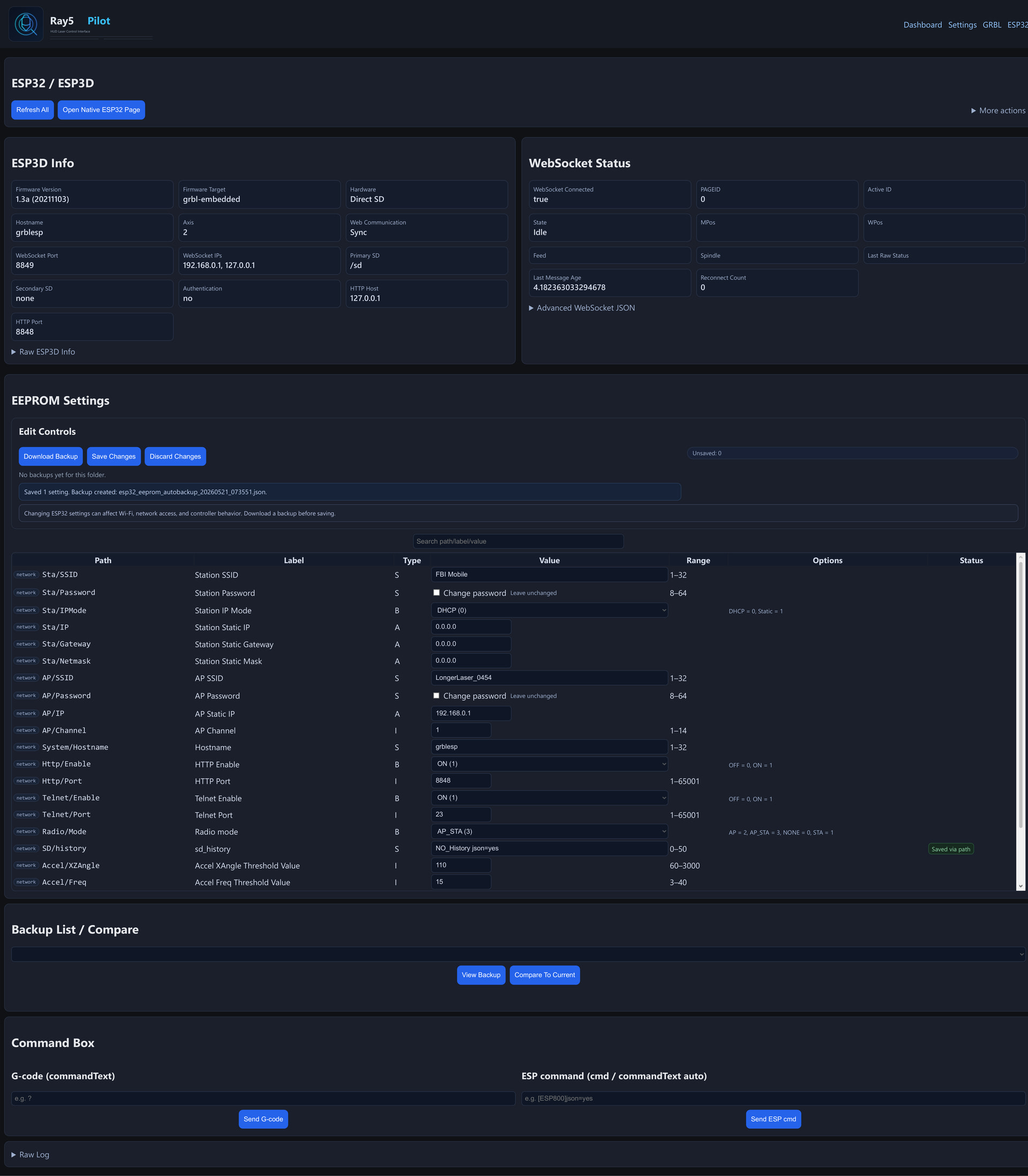

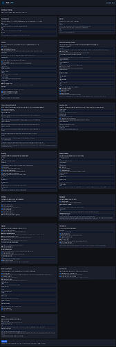

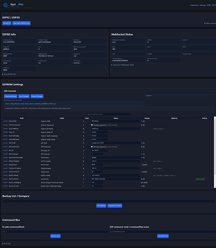

Thank you for your response. I do have a few older demo screen shots in earlier replies. But here are the updated screenshots.

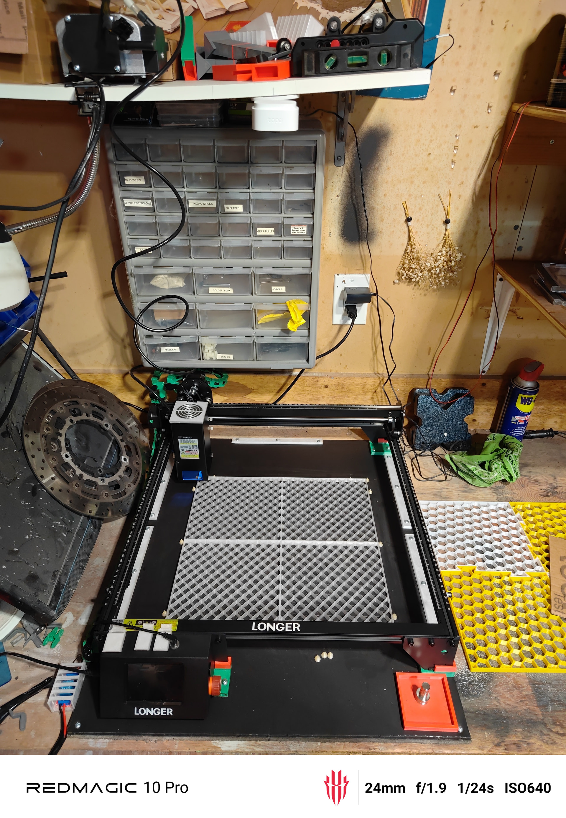

I am using a longer Ray5 20w. This should work with any longer ray5 series, and any watt. But that is also why I am hoping others will be willing to test for me and give feedback.
Here is my simple little setup. Don’t mind my mess ATM. But I have my camera mounted above centered. so I can use that for timelapse, camera feed and overlay. I then drag and drop that skewed image into Lightburn and use it as a material guide to see were I am placing my runs to material.

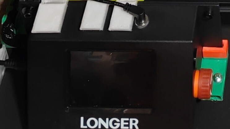

The controller is inside this block:
 ![image](https://forum.lightburnsoftware.com/uploads/default/original/3X/3/6/360021cee55a7d3db88427e01a2992f0d7bbd2d9.jpeg)
If you type $I in the Console Window what you get in response?

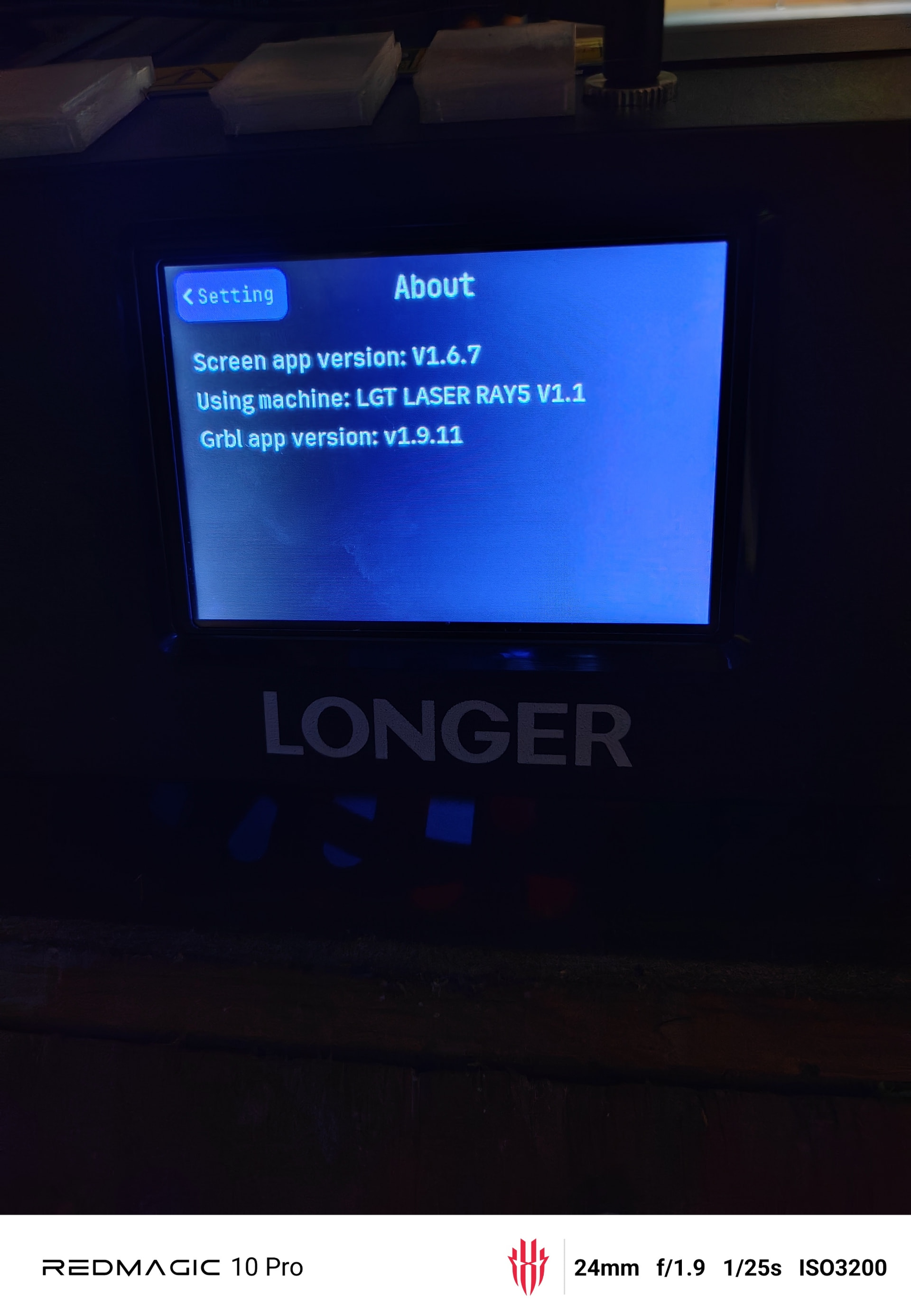

Why didn’t you just say the firmware versions? My apologies.
Here you go:
 ![IMG_20260521_141732](https://forum.lightburnsoftware.com/uploads/default/original/3X/e/1/e1241787fe9b27d24908d4787c1410995ef779c9.jpeg)
[VER:1.3a.20211103:]
[OPT:PHSW,64,256]
[Board:LGT LASER RAY5 V1.1]
[Machine:Longer Laser Ray5]
[Software:v1.9.11]
[Wavelength:460nm]
[Working Size:XSIZE=400.00:YSIZE=365.00]
<div class="post-metadata">
**Author:** ![parsec](https://forum.lightburnsoftware.com/user_avatar/forum.lightburnsoftware.com/parsec/32/118933_2.png) [@parsec](https://forum.lightburnsoftware.com/u/parsec)\
**Post date:** [May 21, 2026, 10:13pm UTC](https://forum.lightburnsoftware.com/t/ray5-pilot-local-dashboard-helper-for-longer-ray5-users/189565/19 "2026-05-21T22:13:38Z")
</div>
Were only to check the board but “LGT LASER RAY5 V1.1” gives nothing, maybe that one belongs to Longer…
