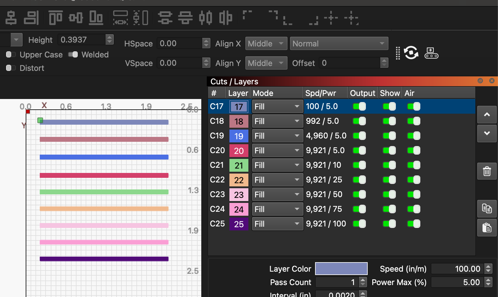

Speed and Power both look good now. The resolution on the laser (LPI in Lightburn) gets ignored though. No matter what I set my LPI in Lightburn to, the laser uses 254.
Any plans to add support for any of the built in cameras on the applicable Epilog Lasers?

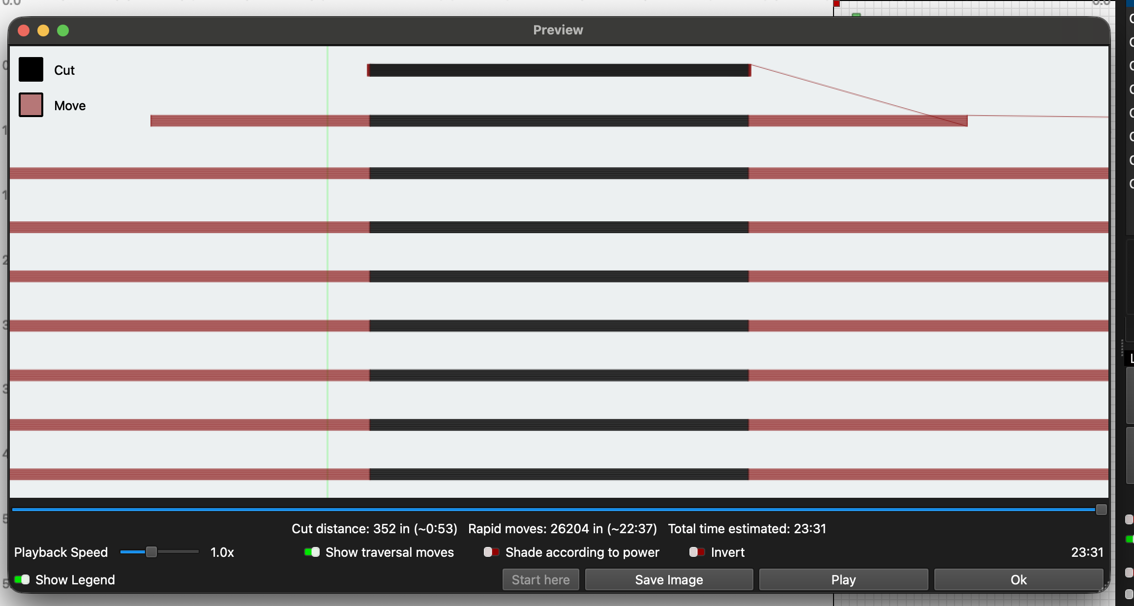

The Preview time is way off… In Lightburn, the preview said the job would take 20+ minutes, the laser completed the job in 1.5 minutes. It looks like it’s the head movement and how much travel there is past the engraved areas. The faster the speed, the more travel in the Preview window in Lightburn.
 ![Screenshot 2026-10-01 at 4.07.03 PM](https://forum.lightburnsoftware.com/uploads/default/original/3X/d/5/d5107608c1735a94be19cba128196ffe2aff8a86.png)
 ![Screenshot 2026-10-01 at 4.07.36 PM](https://forum.lightburnsoftware.com/uploads/default/original/3X/2/f/2fe1b4b46e0889fb75e55a5a97058f5351d1b27b.png)
