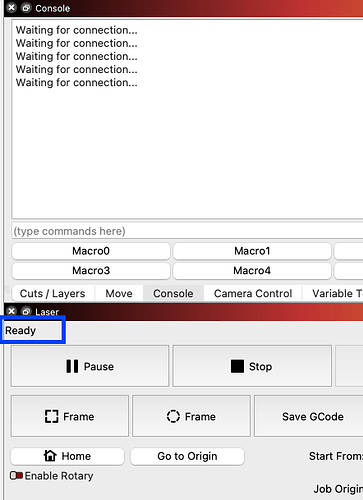

I have checked the archives and found many threads discussing this behavior, but no answers as to why this behavior exists.
I know it’s a source of confusion for many users. In the laser window the status shows ready even though there is no connection to a machine. This appears to only be the case with GRBL machines as far as I can tell. The Laser window says ready, but the console says waiting for connection.
My Ruida shows Disconnected in the laser window when it’s not connected. I don’t have a Galvo machine, so I don’t know the behavior there.
It would be much less confusing, to new users especially, if the laser window said disconnected instead of ready when it’s not actually connected.

Maybe it’s a startup issue. I just started LB 2.0, and it showed ready despite that the laser is not connected:
The laser is connected to COM12 and COM15 is a different USB device. Once I switched to COM12, it connected successfully. When I now change back to COM15 again, the status correctly shows “disconnected”.
