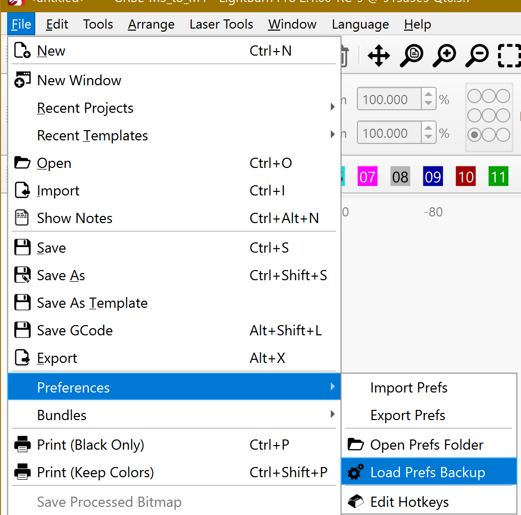

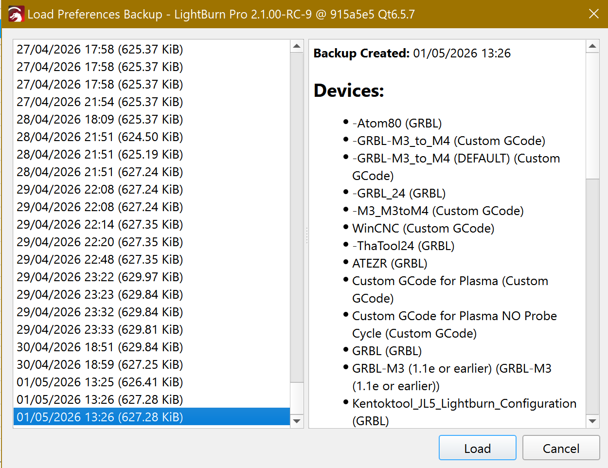

Hi there,
This seems like a beginner issue but after much searching, I can’t seem to find an answer.. though that is only partly true. When I come back to my laptop, Win 11 Home and my Creality Falcon 40w, the laser doesnt restart. I need to shut down LB and then it find it and connects. Ivec tried right click on devices, going into devices and comm etc but nothing seems to work.. I would have thought there were a simpler way?
Many thanks, Neil.

As a start try loading a backup file from when it worked:
 ![image](https://forum.lightburnsoftware.com/uploads/default/original/3X/5/1/51cc74e3c82d812379c7117292e253d8f3d7f891.png)
 ![image](https://forum.lightburnsoftware.com/uploads/default/original/3X/0/e/0e1f8712aa3f090fa38b1d24b025c2ac4c0693b5.png)
