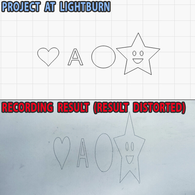

Hi, I need a big help! The recordings are getting distorted, and stretched. The project in LightBurn is normal, but the recording is getting crooked, distorted and stretched.
I’ve tested different burn speeds, and my machine is new, it’s calibrated and the problem I’m pretty sure is something in LightBurn.
I made a video showing the recording and showing the screen with the drawings in Lightburn.

I see 2 possibilities:
  1. you’re getting binding along the X-axis and the stepper isn’t able to move as much as it would like. Check for proper belt tension and wheel tension.
  2. you say you’ve calibrated but how have you done that? Have you checked that you can burn dimensionally accurate parts? Recheck this.
