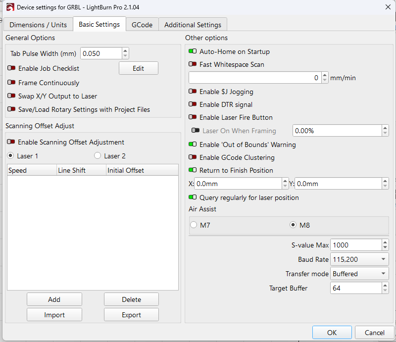

Hi @HenryM
Just for completeness.
I think the behavior you’re remembering is controlled by **Query regularly for laser position**.
Go to **Laser Tools → Device Settings → Basic Settings** and disable **Query regularly for laser position**.
 ![image](https://forum.lightburnsoftware.com/uploads/default/original/3X/d/5/d557382be63d9b4ad32e8f75eed40fe0bd6ac1ab.png)
The red crosshair is the **Show Last Position** indicator. With regular position querying enabled, LightBurn updates it from the position reported by the machine. With it disabled, it should remain at the last deliberately reported/moved position until you use the positioning tools or **Get Position** again.
Give that a try and let us know if that restores the behavior you were expecting.

Hey @HenryM
That was my mistake — please turn **Query regularly for laser position** back on.
With that disabled, LightBurn stops regularly asking the controller for its current position 😅, so the red position marker will not update normally.
Once it’s enabled again, please try the **Click-to-Position** tool and let me know whether the red position marker follows the laser correctly.
