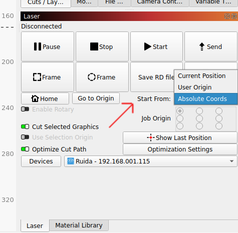

Since there isn’t a console, the machine turns on the red indicator telling you there is a problem detected by the Ruida.
It’s likely a coordinates system error where the code is attempting to drive it out of bounds.
What are you lasing, how fast, device settings origin setting and the _ **start from** _ setting in the laser window.
It’s likely you will have better luck if you use _ **absolute coordinates** _ for a start from value.
 ![image](https://forum.lightburnsoftware.com/uploads/default/original/3X/6/8/685f6c22df207741b306ebb56478cdaf52ba8434.png)
Let us know if it has helped… if not, include a screenshot of both your cut/layer window and your laser window settings.

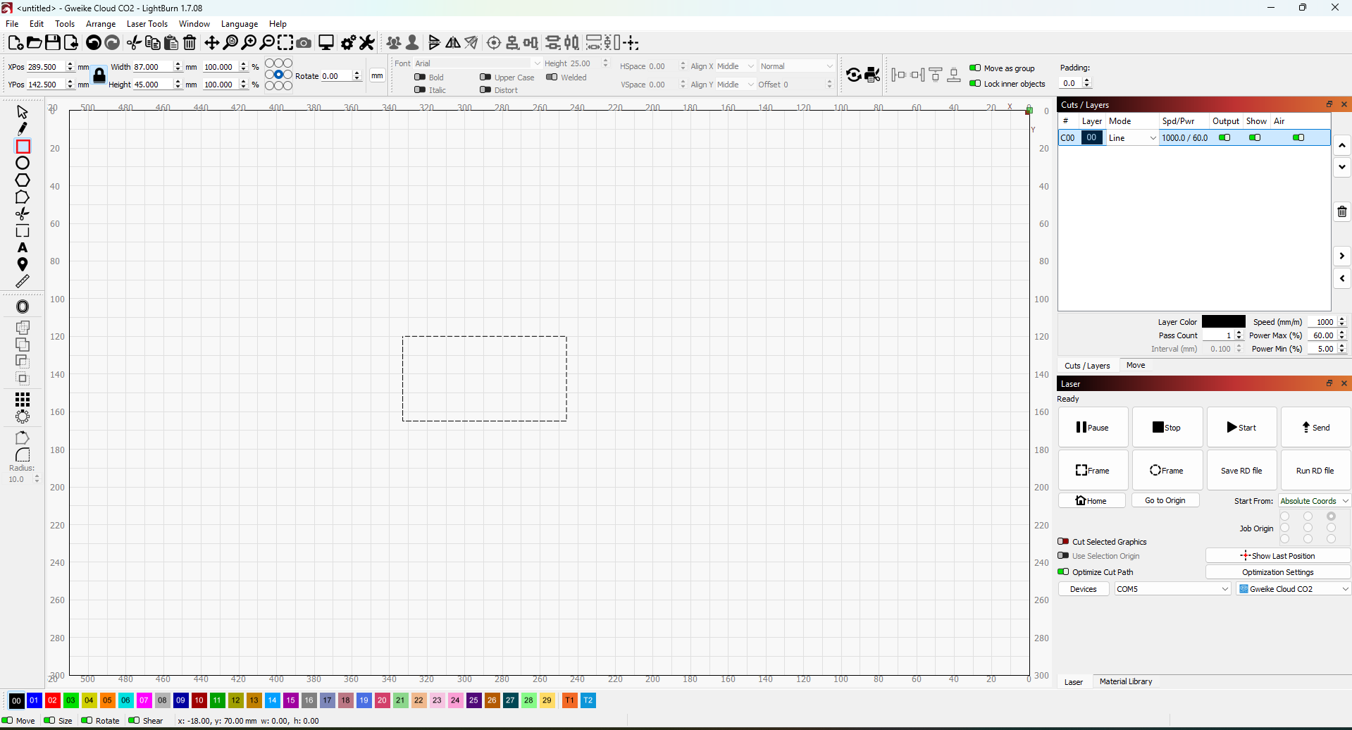

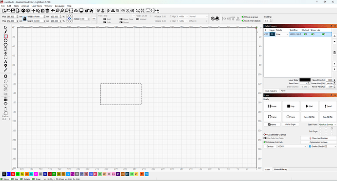

Tried everything and no luck

Post a photo of the device settings or tell us where the origin for your machine is. It looks like it’s set for top/right, I thought they were top/left…?
It’s very likely that you machine cannot run 1000mm/s, which could drive it our of bounds trying to get to speed or slow down… So far, I think your machines origin is incorrect, can you check it?

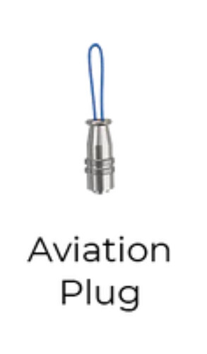

I finally got it working! I thank all that have helped with recommendations, suggestions and support. I have discovered that there are several different versions of the Gweike Cloud CO2 laser. Please be aware that Gweike Tech Support is not very efficient nor helpful due to the many versions of their machines. On my specific machine which is the Gweike Cloud Pro II 50W CO2 laser, Series: G23019-xxxx Manufactured: Feb 2023 there is an “Interlock” located on the left backside of the machine that requires an “Activation Key”. This key must be plugged in order for the machine to execute a job. The instructions and Gweike Tech Support fail to tell you this.
Hope this helps someone 👍🏻
