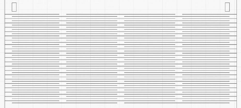

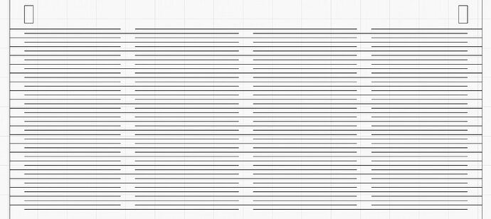

Hello!
I use a CAD Software for my 3D project. So I build them in a 3D environment, generate a drawing and export it as a DXF-File. That is what the CAD Software offers me. Within this 3D environment it is not allowed to have simple drawn lines. I always need closed forms there.
So I want to cut out wood that can be bent. It works.
What I want to improve: It is not lines, it is small rectangles, therefor my cutter runs over this line twice.
The rectangle has some lenght, let’s say 50 mm and 0,1 mm thickness.
My ways so far:
- edit → find doubles (what they are not),
- edit → optimize forms (finds only few of them!!!)
- laser → remove overlapping lines (what they seem not to be)
Is it possible with this software? I would need some help to do it, as I cannot figure it out on my own. Here ist the example how it looks like: The horizontal lines, are not lines at all, it is

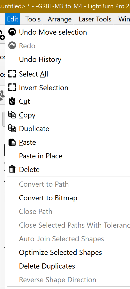

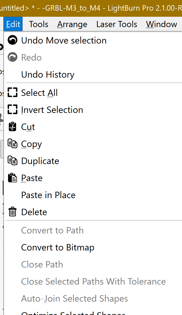

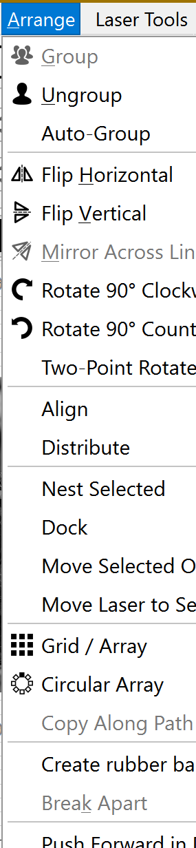

Welcome.
Ungroup rectangles (if grouped) select Brake Apart, Delete Duplicates then Auto-join.
 ![image](https://forum.lightburnsoftware.com/uploads/default/original/3X/1/8/18796e89938f13654044c322cb08e88a5ab20084.png). ![image](https://forum.lightburnsoftware.com/uploads/default/original/3X/0/8/086d4de4171a6ca4d8dbbca686a5ec8f4f3ffd51.png). ![image](https://forum.lightburnsoftware.com/uploads/default/original/3X/9/7/97f3e580ef8230b3b4ad4edcefa61ccb71e538e9.png)

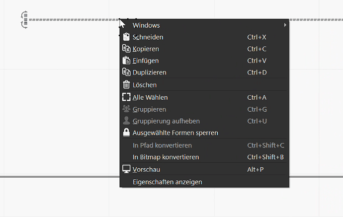

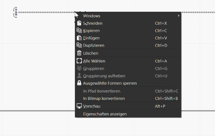

Sorry, I was not finished with my post, but after my edit, I got the message I cannot edit it any more.
So, here you can see another trial:
 ![2026-03-18 20_33_20-380882515@sr-adventures - Remote Desktop - RustDesk](https://forum.lightburnsoftware.com/uploads/default/original/3X/b/a/ba3674673aba6d45d243f9c15c0dae47021e6d68.jpeg)
And thank you for your quick answer. I found your suggested solution, but I forgot to list my efforts on it. I cannot ungroup. It is greyed out… In this case it is only one rectangle marked. But I also tried with Mark All (STRG+A).
 ![2026-03-18 20_40_08- Remote Desktop - RustDesk](https://forum.lightburnsoftware.com/uploads/default/original/3X/9/5/9576c0b71a1f10698595f398efcb9ca23bad65ff.png)

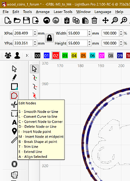

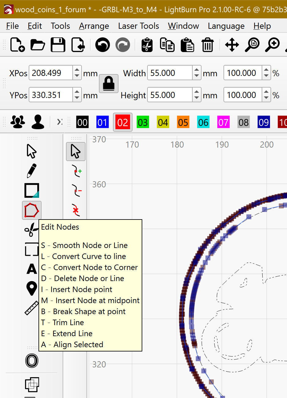

You can try toggle this option.
 ![image](https://forum.lightburnsoftware.com/uploads/default/original/3X/d/3/d3bd762b346f17bb1e327072c7710e75fc69e04c.png)
Try exporting/importing with other formats (like SVG or ai).
Or break the shapes with the Node Edit Tool.
 ![image](https://forum.lightburnsoftware.com/uploads/default/original/3X/2/5/25cd470dfc11ff078497171fab610a3175a4f95f.png)
