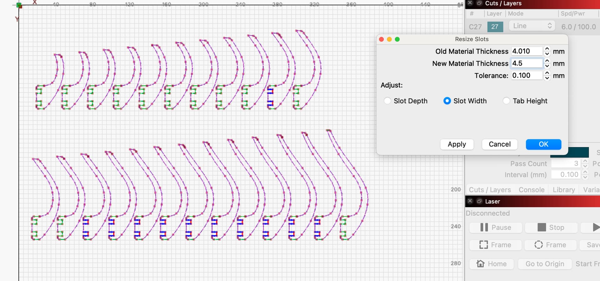

Can anyone tell me why when adjusting the slot size, one changes and the other does not?
I know one is 3.99 and the other is 4.01
would like to hear

Is it before or after you have changed the measurement? What is measured before and what are they going to be
I found 4.01, 4.50, and 5.00, but no 3.99 anywhere. Can you tell us which row and column has this value?
It appears all the slots are 5mm deep.

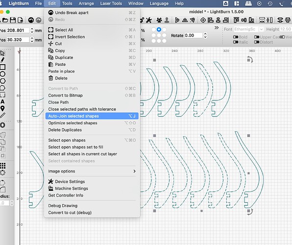

Try to hit “Alt+o” it shows your open Shapes, it could be a problem…
middel-retur.lbrn2 (89.7 KB)

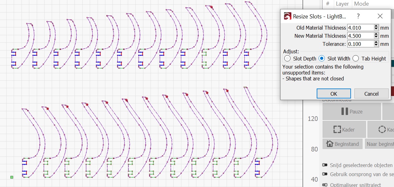

After “Alt+B” and “Alt+J” all Shapes are closed and Resizzer Toole works fine.

the height of the slots are the same, but not all of them are adjusted (see image)

I then select the file alt+b
the pull-down menu file opens and I don’t see alt+j there.
When I look further I see it in the edit menu
auto-merge selected shapes alt+j
but when I use it nothing happens

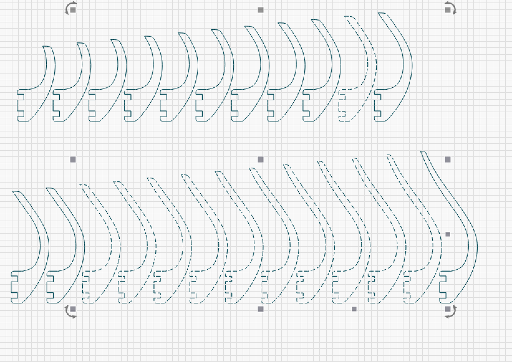

After I load your file, I press “alt+cmd+o”, it shows all open shapes.
(I’m on Mac OS, but see pictures)
I now use this selection to break shapes with, “alt+b”
Then, with selection still active on the affected items, I press “alt+j” to reassemble the shapes.
When I now deselect everything and check for open shapes, again with “alt+cmd+o”, the system finds some “leftovers” from the last operation (I think), you have to delete them, then all shapes are ready to be resized.
I have just tried the second file, here there is the same problem with open shapes and it also has “leftovers” that must be deleted.
Let me know if it works for you :+1:
